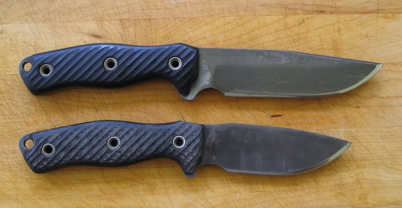

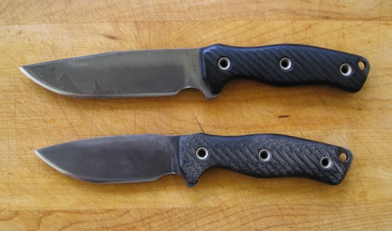

I am having trouble getting on Rat Chat, so I am posting here. I've been playing around with vinegar patinas yesterday and today. I just remove all oils and protectives from the stripped blades and soak them in a pan of ordinary vinegar. After an hour or so they look like this:
This requres little effort, skill or technique. It's too hot to work hard outside right now.
If you wipe them and rinse them, they are more even, but if you let them air dry some and then re-emerse them, you get a mottled look. Then you just dry and oil them, and maybe touch up the edge a bit.

One question, if the option is available to remove the grips,as in the case with the Rangers, why dip the knives with the grips? I've always removed them. Obviously, you have no choice with the hollow pins...just wondering.
