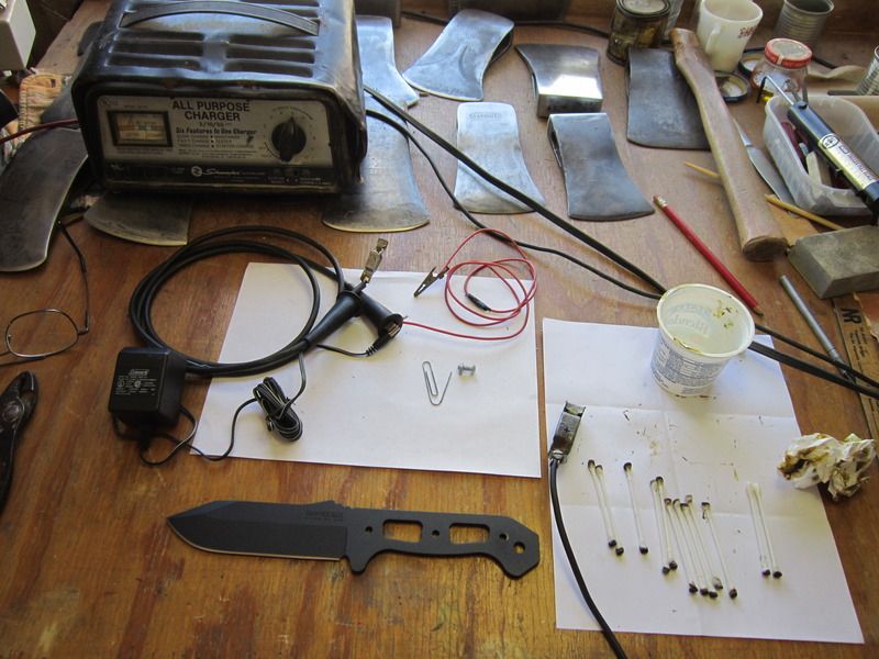

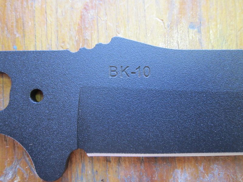

Im going to leave the Black Paint on for now and use it as is. Wanted to get the etching deeper before I used it so it will be good to go when I strip it in the future
I connected the lead to a screw I put in the grip screw hole instead of scraping any paint off the blade. I noticed there is always a little metal showing at the last screw hole. Maybe that's where they connected for the factory lazer etch
DC etch, plus AC blackening with a Colman Latern wall charger
