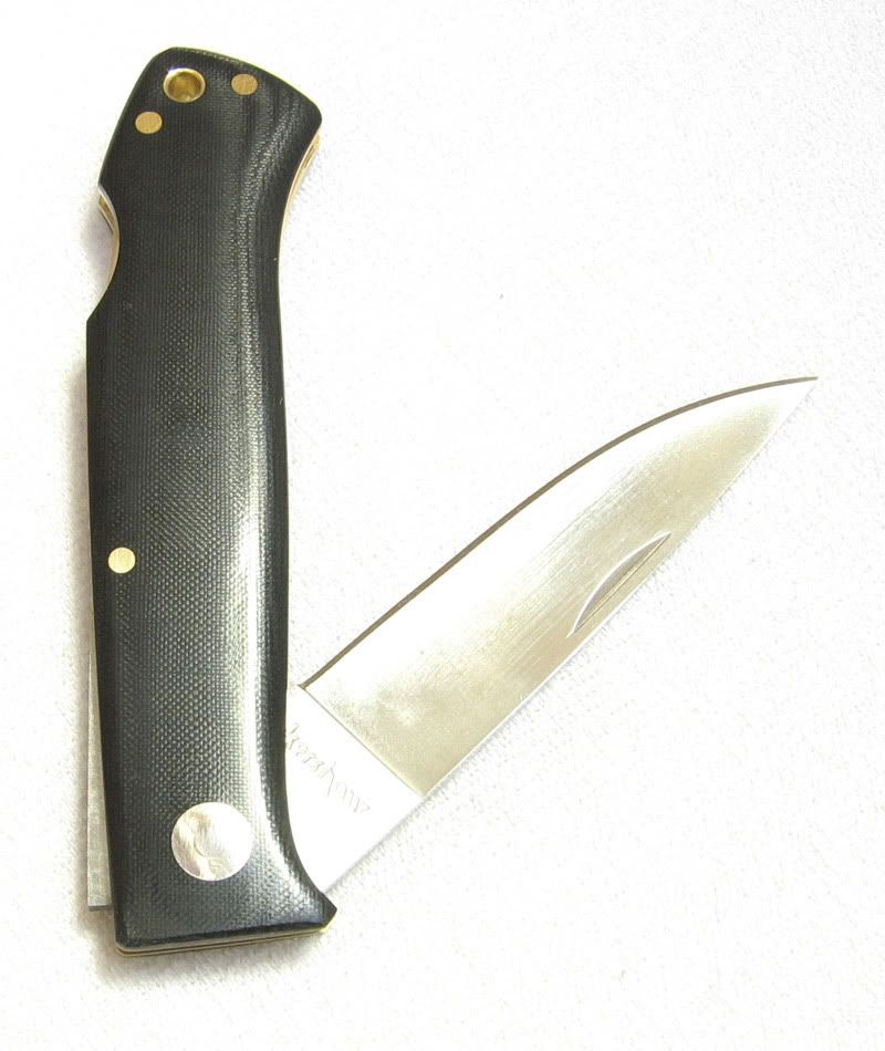

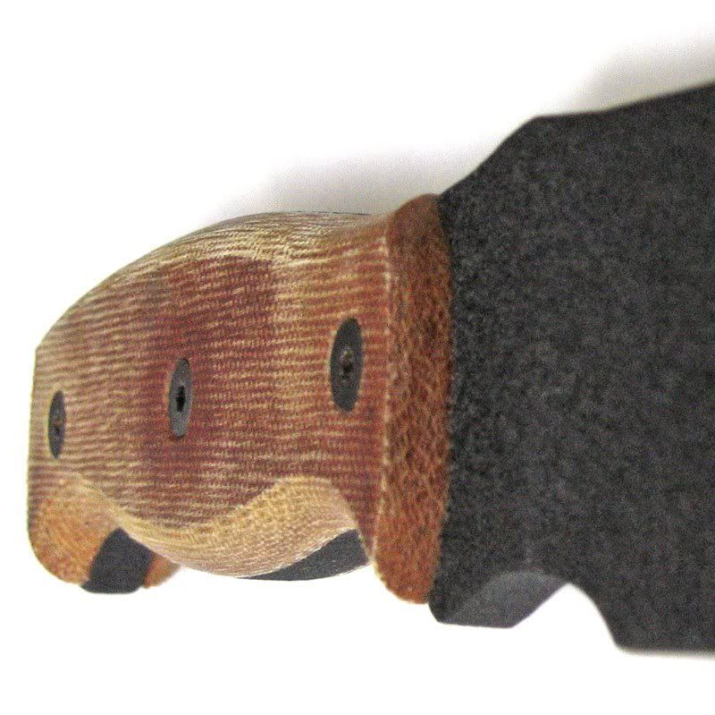

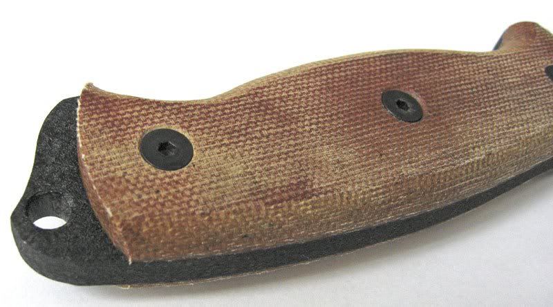

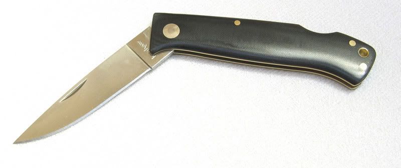

There is Canvas, Linen or Paper Mircarta, referring to the reinforcement used. The difference in strength between Linen and Canvas is small, with an edge to Canvas (Sails were made of Canvas and not Linen, that is a hint) and so the Canvas Mircarta should be slightly tougher. Woven Canvas is also coarser than linen and the appearance of Canvas Mircarta is rougher, less well refined and not as polished, but it offers a bit more grip when wet. Paper Mircarta is even more shinier and looks "more elegant".
