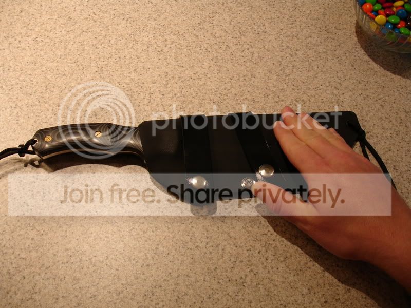

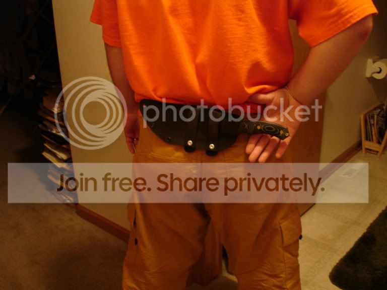

Hi all. I thought I'd share my first attempt at a kydex sheath. The knife I made it for is a RED Scorpion Six-Blades WSK. Go easy on me...
Sheath on person (Duh! I didn't realize where I was standing at the time!):
The sheath and belts are .080" Kydex. I put the straps on with the shiny side out to give them some contrast and to maybe grip the belt better:
The straps are held in place with a screw/snap combo. They can be removed and moved to different holes if needed (mostly the second strap from the sheath opening). I tapped on the snap nipples a bit to give them a little more of a flare, so they would grab firmly. By doing this, I hope to minimize unintended snap disengagement. I apologize about the blurry pic:
And here's the piece out of its sheath:
I originally heated the kydex in our kitchen oven for the basic forming, and then fine tuned the fit with a heat gun and repeated trips into my homemade press. I may or may not touch up the hardware with some black paint.

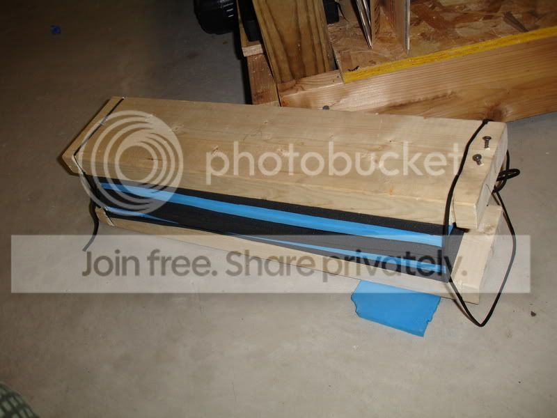

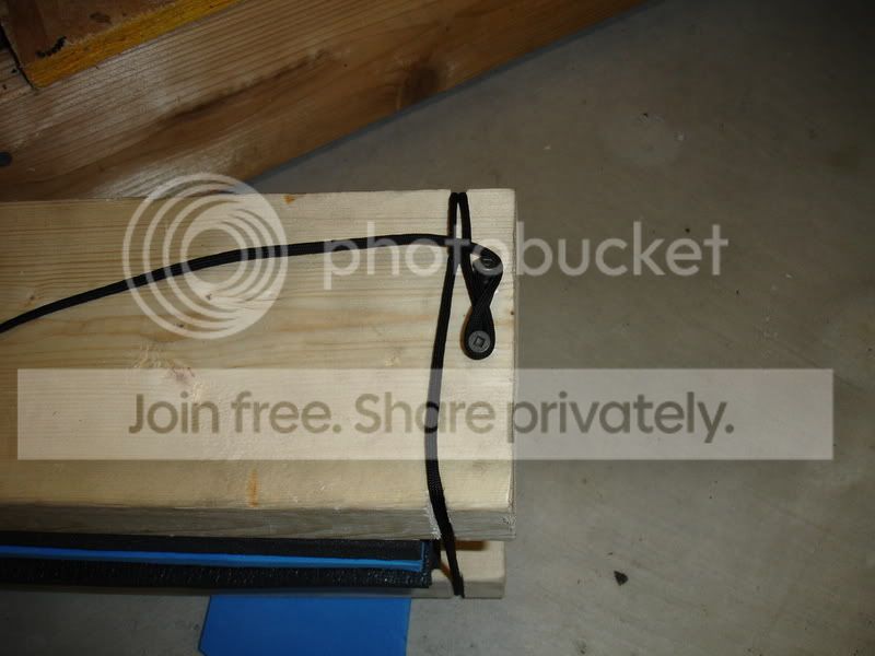

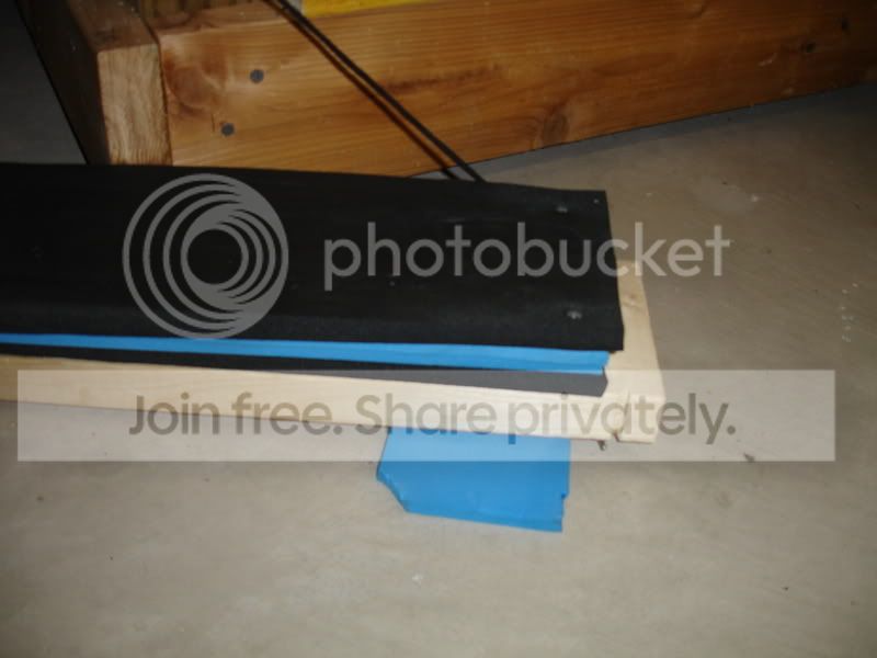

Here are a few pics of my press. I used a scrap 2x6, blue closed cell foam from a Kmart sleeping pad, and black open cell foam used in some of the gear bags we manufactuer.
The press is currently hinged with paracord on one end, but can be easily configured into a sandwich-type press for longer pieces. I made the press this long as I have a Becker Patrol machete that I'd like to make a sheath for someday. At least I thought that part out ahead of time!
Side note, I used the RS6-Blades Predator to cut the cord notches in the press. Woo hoo!
