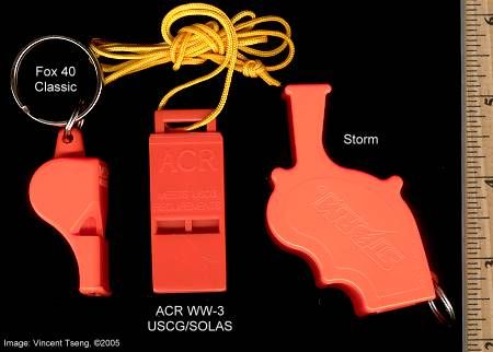

Here's my very meager selection:
The Fox 40 Classic and the full-size Storm are what I'd consider very loud - or at least much louder than one would expect from a whistle.
They are uncomfortable/too loud for me if blown in a confined enviroment - like in a small bathroom
The ACR WW-3 USCG/SOLAS spec'd whistle that I recently got some of - I would consider average loud - an explanation - it's the level I would expect for a good whistle - so perhaps nothing special - but then it probably is loud enough for most purposes - I'm making that assumption since it meets USCG and SOLAS requirements.
I like the Fox 40 Classic since it is very loud for its size - I don't have any problems blowing it loud (the ACR WW-3 takes about the same effort).
The Storm is a too big for me (looks huge) - but I like the pea sound - varying tone, "trilling"(?).

A couple of observations on the ACR WW-3 USCG/SOLAS compliant whistles -
There were some that I found did not produce the lower pitched frequency as easily as the others in my batch.
At first I thought it was just the plastic flashings, but cleaning those up with a nice sharp blade (of course :) ) and making sure the narrow whistle slots were clear with the tweezers from a SAK - all this still only gave variable results - those whistles continued to seem harder to produce the lower pitched tone - relative to the higher pitch channel/chamber.
I wondered if any debris was still blocking the slots so I rinsed the whistle with some running tap water.....
and surprise - each and every one of them started to behave like the best of the batch - ie: I could easily produce both tones easily and loudly......
I just tried those again - after they've fully dried - they just don't seem quite as good as last night when wet - so I rinsed them again - and again they were easier to blow and sounded both pitches louder.....
hmmm.... I wonder what is going on - do these USCG/SOLAS spec'd whistles really need to be wet/in water to perform?
Or are these just faulty?
Another thing about these ACR WW-3 is that they lack a bite ridge - the mouth-piece is just flat - which makes holding the whistle hands-free in the mouth harder - like when I'm cycling - I tend to have to bite harder to hold it.

Since I have more than one of the ACR WW-3 USCG/SOLAS whistles I can compare (unfortunately? :o )
Normally I don't just try to blow a single channel - but just normally as a regular whistle - the ones I think are "good" seem to produce a dual tone that seems lower pitched than the more "difficult" ones.
Obviously when attempting to clean up those more "difficult" ones I have blown just a single channel to test/compare. The lower pitched channel is easily sounded on the "good" ones - and more difficult on the "difficult" ones :p - until they are wet - at which time they are just as easy on that single channel or blown normally - and when wet on both channels they sound the "same" as the "good" ones......
whereas when they were new and dry - they sounded higher pitched and I could not hear the lower pitch as much - which I believe is the pitch that's suppose to carry distance?
If all of these behaved like the "good" ones then I would rate them pretty highly - I don't like the variance and the fact some needed to be wet to work as well.

Vincent,that is interesting and there probably is something wrong indeed, I believe the lower pitched channels should sound when blown individualy, it is the higher pitched ones that sometimes are in the inaudible range, I have to agree with Paul and believe that you wont find better than Acme or Fox.
