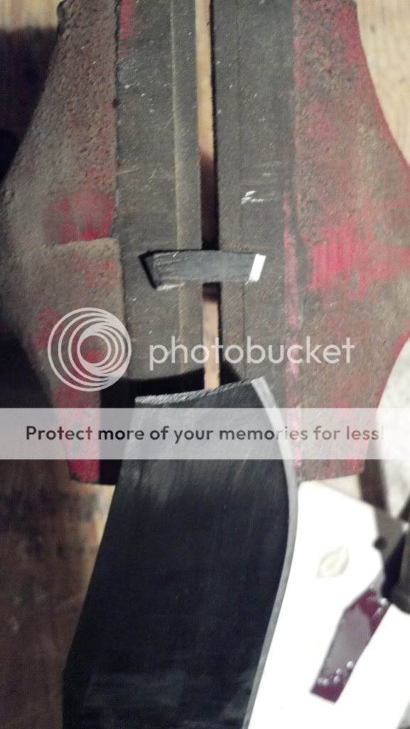

In the discussion thread for my first (accidental) Heavy Bowie break, Bladite made the following comment:
if you're feeling brave, try it again with what you got left
Bravery had nothing to do with it, but I did have a few beers and of course at that point it seemed like a great idea, so I stuck the thing in my vise and took a video.
Video is at the bottom of this post, but first a few things:
1. I in no way think that the fact that the knife broke in a vise is evidence that KA-BAR made a bad knife. If I was just a little bit dumber I'd go grab my RAT-3 and my BK-11 and do the same test. I'm guessing I'd see something similar.
2. Don't try this at home. I'm lucky I'm not picking metal shards out of my nuts right now.

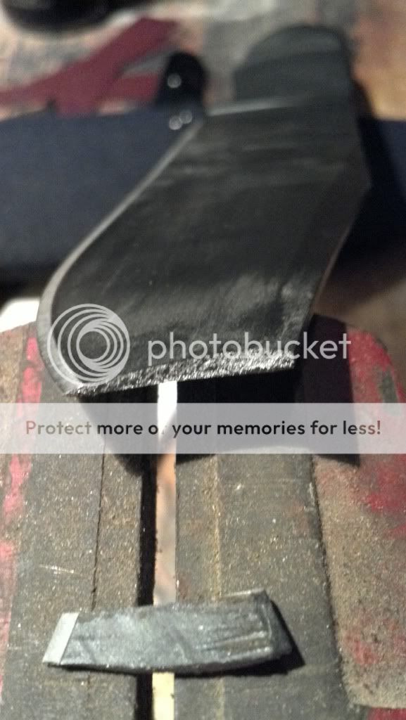

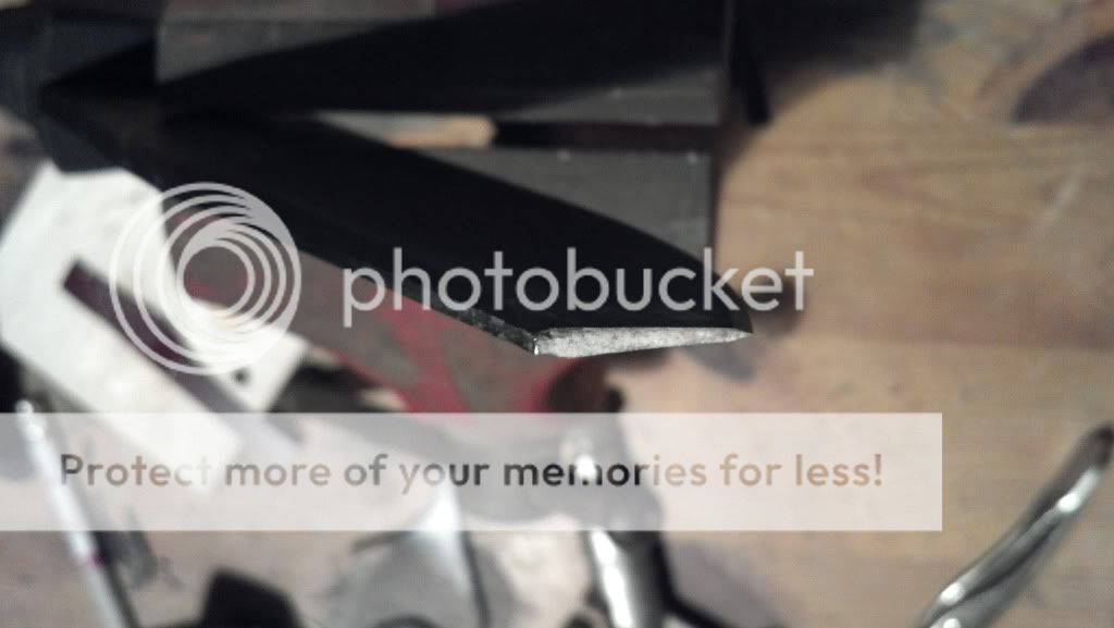

3. I mention in the video that after the first break and then sitting in my closet for a few weeks, the bare metal developed some weird white oxidation. Here's an okay-ish photo of the odixation.
And after the second break, just bare metal.
And the video (if for some reason the Photobucket embed doesn't work, post up and I'll try YouTube).
Now that that's out of the way, it's grindin' time.

that's kinda grainy looking metal there. weird.
i believe there's a video (somewhere) of Ethan sticking a BK11 in a vise, and prying really hard (with a cheater bar). knife did not break.
and some other people as i recall have some similar things, and the knives more or less go back to true, depending on just how hard they did it.
course, some break too :>

BRL,
I'm with Bladite. Grain looks kind of large. Unless you baked the knife in an oven for several hours the grain should be smaller. When you are done testing, send it in. I'll send out a new one.
.....And don't give me any arguments.:D
