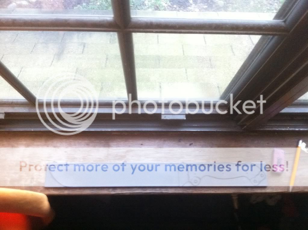

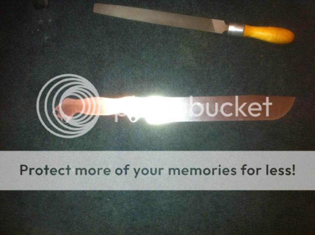

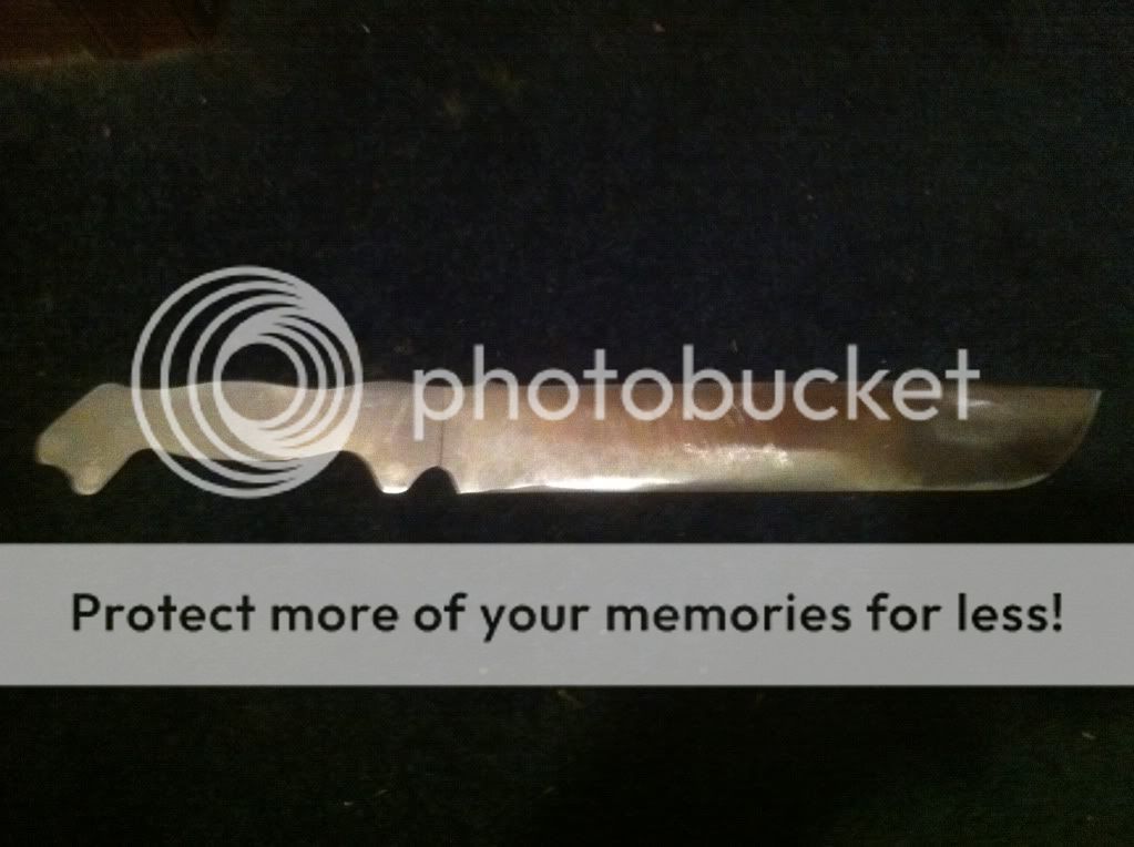

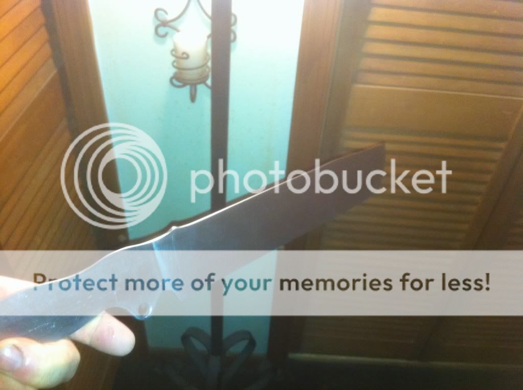

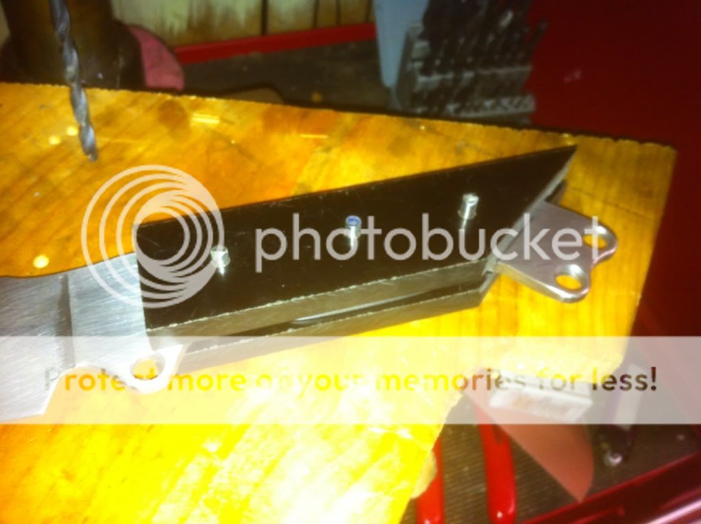

Please give me some feedback for my first try at knife making. It is 1095. I built a Reil Burner and HT it myself. It is 17 1/2" long 2" wide. Paper micarta handle.
I made it to fit my hand. I used hand files and took off a little at a time until it felt the best in my hand. I am building a belt grinder next. I did this knife with a saws-all, 4" disk grinder, hand files & a bench top drill press. It took so long to do everything with the hand files. halfway through I was wishing I had made a smaller knife. My next project is gonna be a 2x72 belt grinder. I was trying to copy the battle mistress.

Thanks man...I would love to be able to do this stuff for a living someday. Its reassuring when someone tells you you have talent, I appreciate it. I did feel a little bad coping someone else s design. I just really wanted one so i just made it myself. I am going to do my own designs from here on out. Im gonna start with some steels that are more simple to HT for now like 1084, O1, & 5160. I was able to get the 1095 pretty hard I think. I did an edge quench and I even got a visible hamon line. But it took me forever and the last couple inches of the blade down toward the handle didn't get as hard. I now know this is because the blade was so long I had a hard time evenly heating the entire lenght ( I needed 2 Reil Burners I only made one) and 1095 needs a good soak once at critical and you have less than 1 second to go from critical to below 900F. So 1095 is a bit more fussy than 1084, O1, or 5160 would be. I think I would have been fine if my blade was smaller or if I had another burner. But the top 3/4 of the blade are very hard. I wish I had a Rockwell tester to know for sure. I'm gonna do some testing of edge retention and video tape it and post it on You Tube as soon as I get a chance. I think it will do pretty well though. I could tell when I was sharpening it. I'm thinking of doing a small hunter/skinner next, with a drop point and a handle with a couple different materials and some spacers and palm swells. Either that or some kind of dagger. Anyway thanks for the input. I look forward to making a knife for you someday.
That bad boy looks pretty darn good for a first knife! I was racking my brain trying to figure out how you did the spider webbing on the blade finish until I saw it was a reflection of the chain link fence in the back ground! Keep up the good work!
