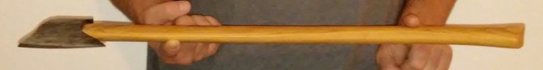

If you ever decide to make a new handle down the road, here's a demo of the principles I described at work, and it's super easy to identify the right handle shape under that method. Pardon the couple of slightly blurry pics, but self-timer photos don't always come out right. :p
First up is a Council Classic Jersey on the factory handle. You can see that with two points of contact on the main length of the handle it will lay dead horizontal.
Next up is a Rinaldi "Trento" pattern axe from Italy, on its factory handle, which has a large, deep bit and very little poll. As such, it wants to hang bit-down. This isn't a problem when making downward cuts, but it means that making horizontal cuts on standing trees requires some compensation in your technique.
However, I really like the overall performance qualities of the particular axe, and so I made this handle for it (still in the final stages of fitting) that puts the main length in alignment with the center of gravity. Because of how bit-heavy the head is, this required a significant offset in the neck of the handle. However, you can see that it now balances horizontally when held along the main length.
There are a lot of axes that, unlike the Council, don't have the handle aligned with the center of gravity. In most polled axes, however, the amount of offset needed in the neck to correct this is pretty minimal. A big poll-less head like the Trento is a deliberately extreme example.

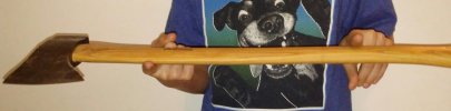

An adult
20170505_145311.jpg An 11 year old holding the Wetterlings, lol. Parlour tricks. Bad form.
Unfortunately when swinging horizontally you will not have two distant points of contact on the handle. So holding the Apex of handle curves to prevent the bit heavy nose dive is not happening. And if you do try an use an ax with two distant separate points of contact horizontally you will quickly learn why that is a sucky way to go about things. Lol.
