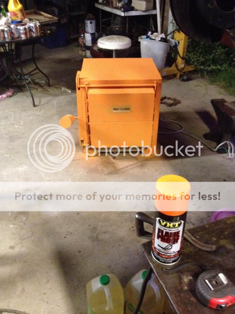

So I scored this beast Monday afternoon for $100.
It wasn't orange when I got it, so I fixed the cosmetic issue.
It's a Thermolyne Muffle Furnace Type 13300 with a Furnatrol II by Sybron programable controller. (I took the controller off for dimensions and repair)
The only issue is that the controller was operational for about a minute before it crapped out and started smoking. I believe that this has to do with the way that it was stored, because it smelled like pee, and had insect eggs and rat poop in the controller box. It was also in an enclosed metal building sans air-conditioning. The brick and interior are spotless and pristine.
From what I understand, reading the product literature, the unit is a type 810 and is a three-term controller, 2 alarms, etc... but I don't know if it has the capabilities to store multiple programs, and if it does, how many programs?
My question is would a newer digital PID retro fitted be a more formidable option when it comes to operation as the literature makes them seem a bit more capable when it comes to programing and ease of use? Access to stock replacements such as takeoffs and used program controllers range in price from $24-$340, but I see that option as a crapshoot of "if". The newer digital controllers seem to be a bit more handsomely priced in comparison.
Any advice is appreciated. I may have gotten myself into a pickle here, but the price and overall condition of the furnace was worth the gamble of $100 considering it's already wired with the heating elements, refractory, and industrial capabilities once operational.
