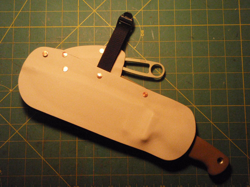

A fellow forumite requested a Piggy-Back addition to my 'normal' sheath design for his SOD (Son of Dogfather):

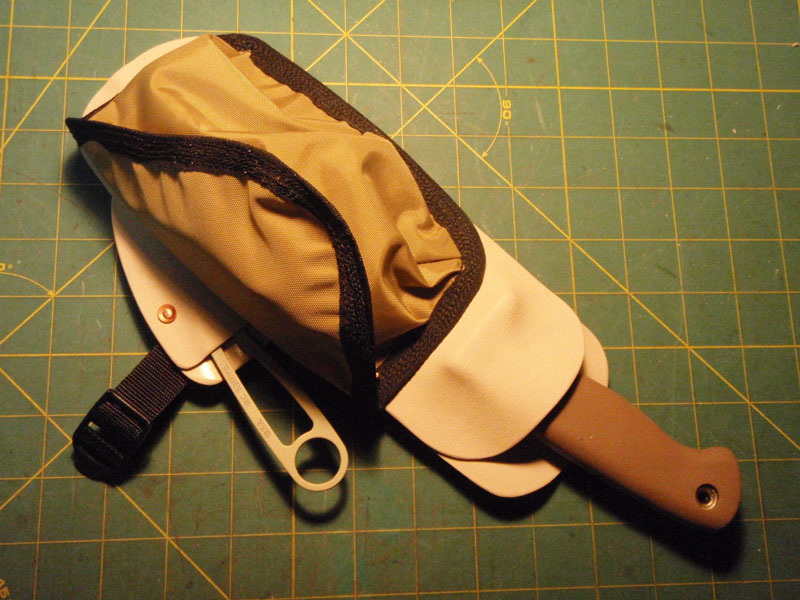

As you can see, I molded the Kydex off-center to accomdate the sub-sheath, and am mounting the pocket over it:
Note that not all the rivets have been pounded on as yet...

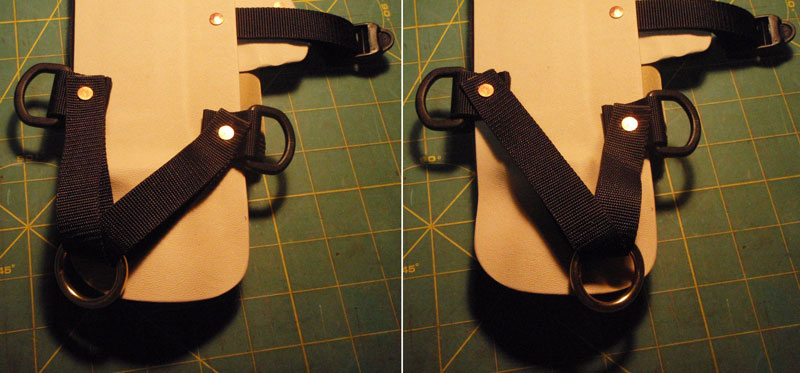

More; for low-ride carry, using an "equalizer" of sorts helps the sheath from binding while moving. To make
'em, I double over some webbing, and then feed the ends from opposite directions through a brass ring:
This allows the attachment point (brass ring) to move smoothly from side-to-side:

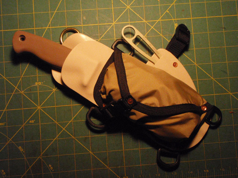

Getting closer - all that's left is the rest of the suspension system:
Should be ready for Sunday's festivities!!

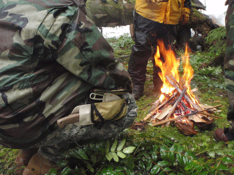

Finished it up; and SnakeDoc wandered off into the brush with it Sunday...
It were 'orrible; we almost DIED :eek: ...!!!
Gak,
8
Yeah, would have been nice if you stuck around to watch me fail at fire making!! Rescue Mike gave me some pointers and helped me out a lot! By the time we left I was soaked ALL the way thru, and opted out of the de-briefing at Walking Man. By the way, thanks for letting us take turns with your Mistress!! ;):D;)
