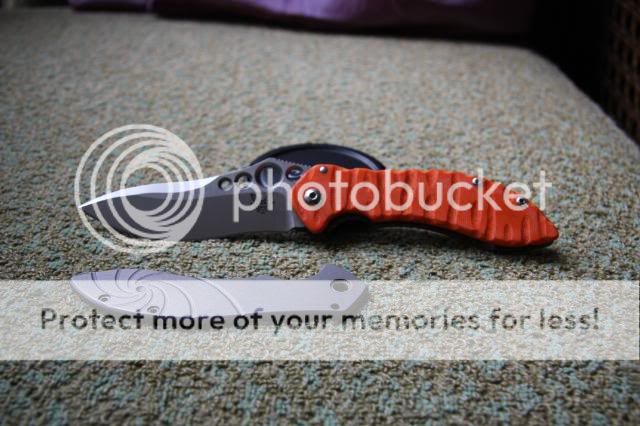

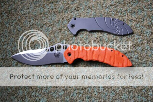

Ok it not a umnum but both are ti:D.
Pimped my mini skirmish with a orange g10 textured scale.

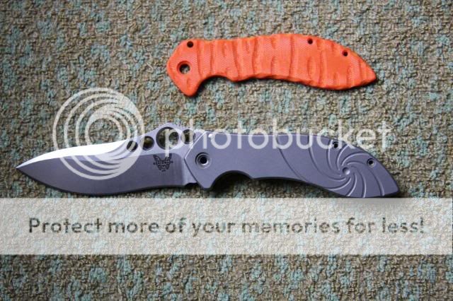

The sebbie was pimped bij Matt Cucchiara.
He has done his fizz job(little holes),rounded the edges and blue anodized the grey ti scales.
I made a new scale for it.First it was just flat g10 but found this a bit boring so did some texturing on it.

Hello Tony,
i don't want to sell the fizzed scale.
It is blued en rounded just like the lock side and it should stay a complete cucchiara pimped knife;).

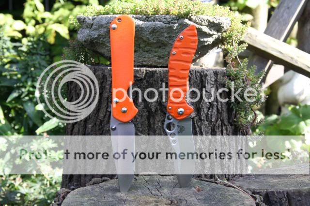

The orange g10 scale was a little try out.
I had 2 scales of g10 so made 1 for my bm and 1 for the crk.
I sometimes swap the scales and at the moment both knifes have ti scales.
