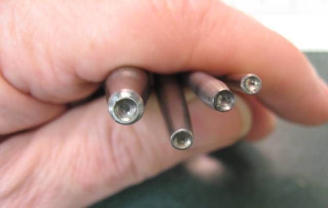

You can simulate spun heads and refine peened heads by using cupped punches. Using a punch that is sized for the rivet head, you simply tap the punch with a hammer to refine the head shape.

Also, some home made cup punches in various sizes.

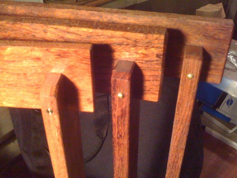

Since I have gotten into woodworking, quite a while ago now, I started to look at nails both wood and metal and the friction fit ALONE as opposed to say . . . a slip fit pin and peening the ends.
Adavantage ? ? ?
one can take it apart easy with just a press. Can even use the drill press in a pinch to assemble or disassemble.
So . . . finally . . . my point and question : for knives do you ever just press fit pins rather than pean ?
Two examples see photos :
The wood structures have press fit brass pins.

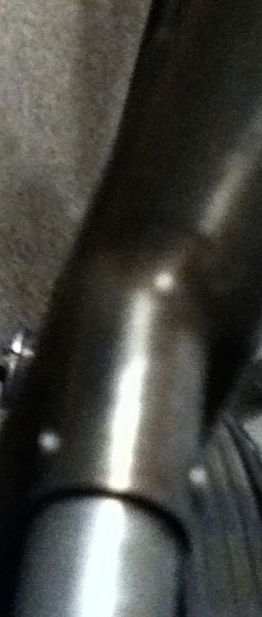

The all metal joint is aluminum solid rod into a cromolly super thin wall tube and a stainless steel pin (there are several in the structure). It is a fairly dynamic structure that can be prone to screws loosening over time. I left the pins long and flat on the ends during testing incase it was an unworkable combination and I had to peen or replace with a tighter fit. So far, with daily use they have all stayed in situ.
Advantage : I can press the pins out to replace components without much fiddle and ultra clean look on finished product.
To be clear I am not asking for advice on that project I am just directing my question to press fit pins in KNIVES specifically and using those as examples to try to get across what the heck I am talking about.
