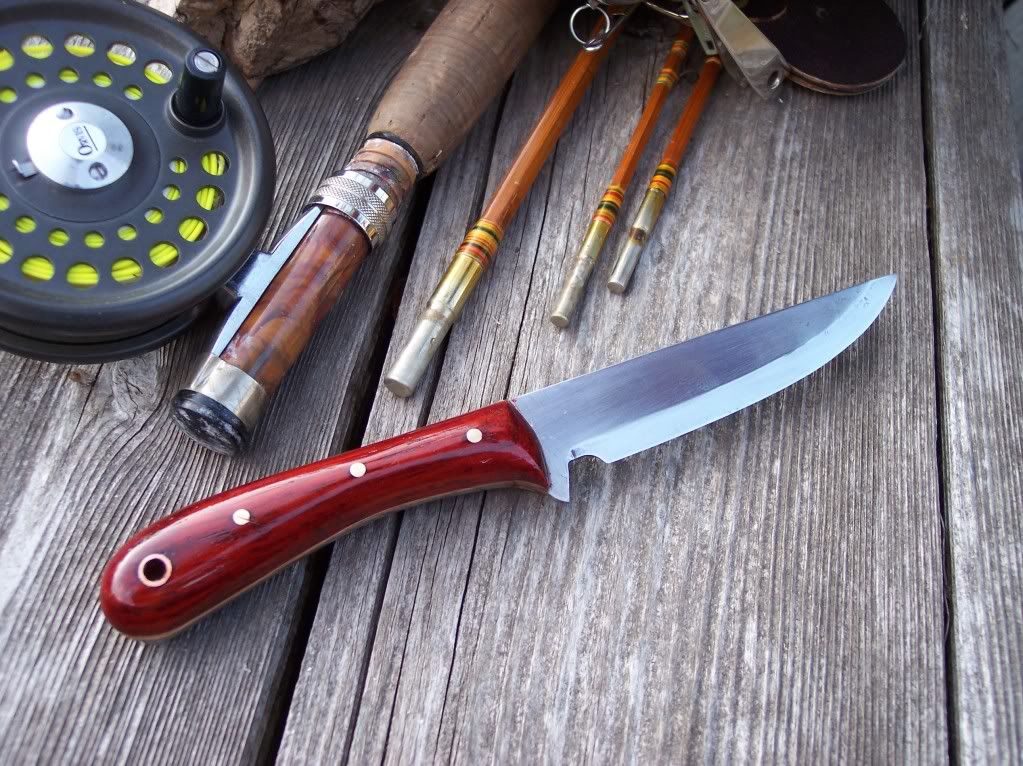

I make full-tang knives and usually epoxy the handle scales to the tang and pin them in place using bronze welding/brazing rods from the hardware store. Lately though I have been changing to something that looks like a pin when installed but something that will hold better. I've been using small brass or stainless steel bolts.
I drill a hole that is not loose enough for the bolt to slip through but only just tight enough so that I have to use a screwdriver to get the bolt through. The hole can't be too tight though or screwing the bolts in might cause the wood, or whatever I'm using for handle material, to split. My thinking is that with the slight thread contact along with epoxy in the holes the bolts will hold the scales to the tang more securely than a relatively smooth pin will.
After cutting the head of the bolt off and filing it flush with the handle material it looks like a pin. Any thoughts on this?

I have used this method on a half dozen knives or so. Here is one example:

I understand what you're saying but this has not been a problem for me. I agree that heavy contouring could be problematic. Maybe it has worked for me because they've been in places where there wasn't much contouring or rounding over of the ends.

I'm not saying that this is a great thing to do in all situations. But It seemed that it could be a system that would grip the handle material better and still look good. The threads can certainly be a problem on heavily contoured areas and this would be a place where it should not be used.
