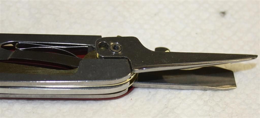

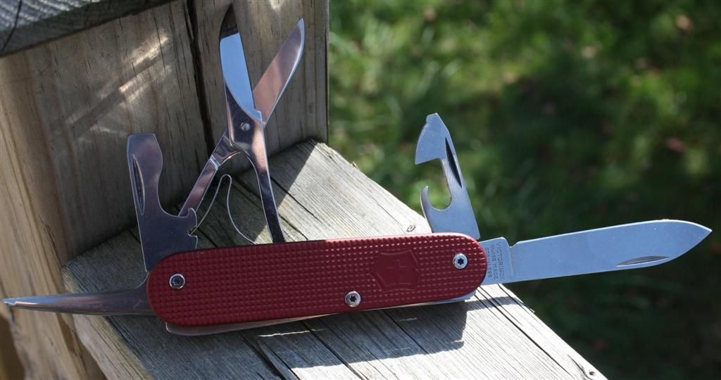

I finally got this sucker done... urban pioneer jr! Pioneer Cadet with scissors... Well whatever the name will be here it is
This one was brewing in my head for quite awhile, and I've always wanted the pioneer awl on the 84 alox cadet frame.

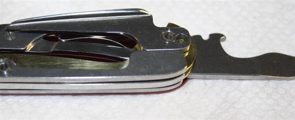

This is red hard anodize with c260 brass liners. The keyring had to go to make room for the awl and I made a custom piece in brass to take it's place.

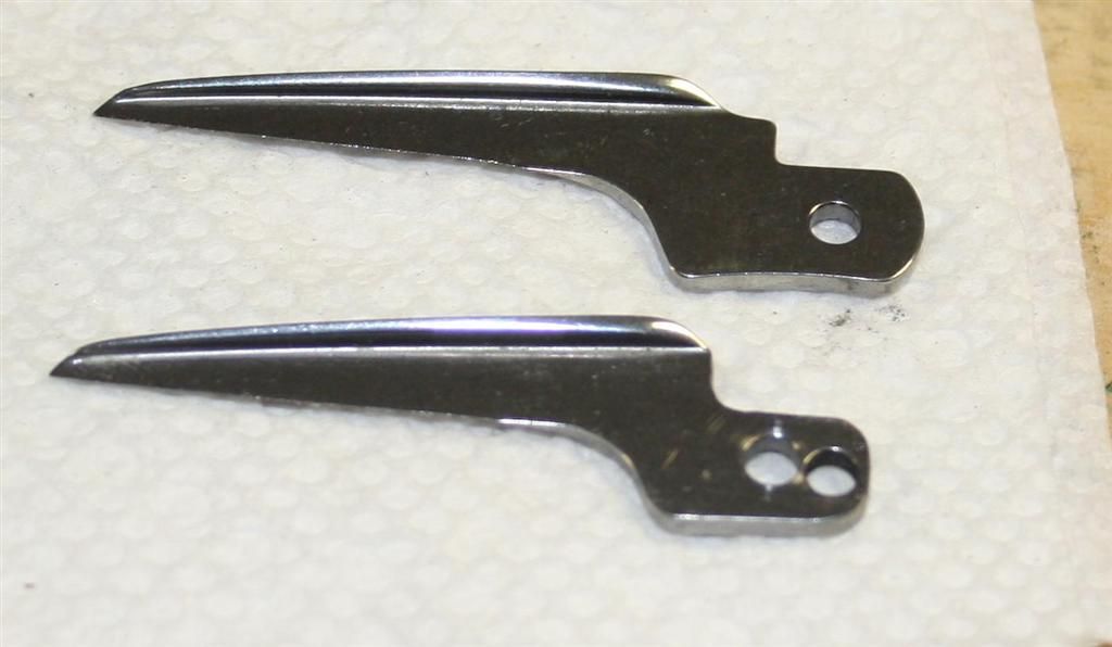

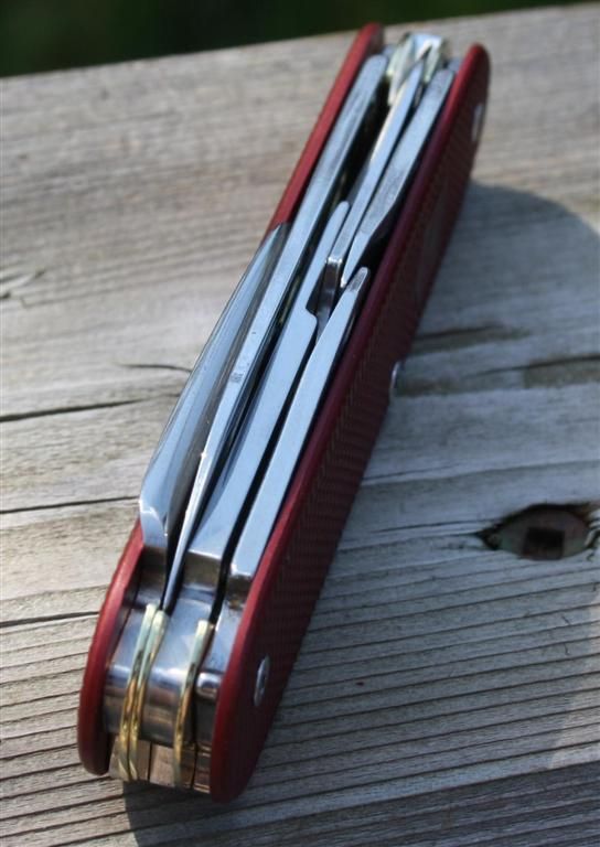

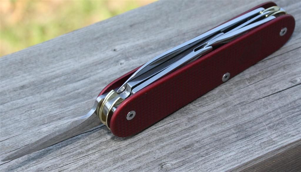

Here is what the awl modification looks like. I made a new pivot hole and removed some stock metal to get it to fit.
