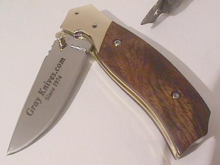

Well, I got Illustrator to work out a pretty good prototype. I got the mechanics worked out using the basic drawing tools, then shaped the handles and blade, then printed a few copies and cut the parts out. Over lunch I spent a VERY frustrating couple of hours working everything out, but as of right now I have my liners shaped and the general mechanics of the knife work. I just need to shape the blade, make a standoff for the spine, cut and drill scales, blah blah blah. A lot of work when you're using a hacksaw! Also, I burned out two bits on my 1084. I have a bar that has frustrated me for years. It's really soft on the outside but the center is hard as hell. I have to just burn through it but it obviously kills my bits. Of the 6 #15's I bought last week from MSC only one is left. :(
But, other than a crappy piece of steel that has plagued me since I started this hobby, the only real issue is that my 1/8" pin got drilled a little higher than it should have, so rather than going with a Wharncliffe like I planned on I'm going to have to use a different blade shape.

I guess if I really wanted to I could just breakdown a few of my production knives and copy them. But, Illustrator worked out well for my "CAD" prototype! Unfortunately I drilled the stop pin hole a little too far south and it screwed up the blade shape . I guess I could drill it again, but that will cause some other problems, so I'll stick with what I have for now and just see what blade shape wants to come out of this.
