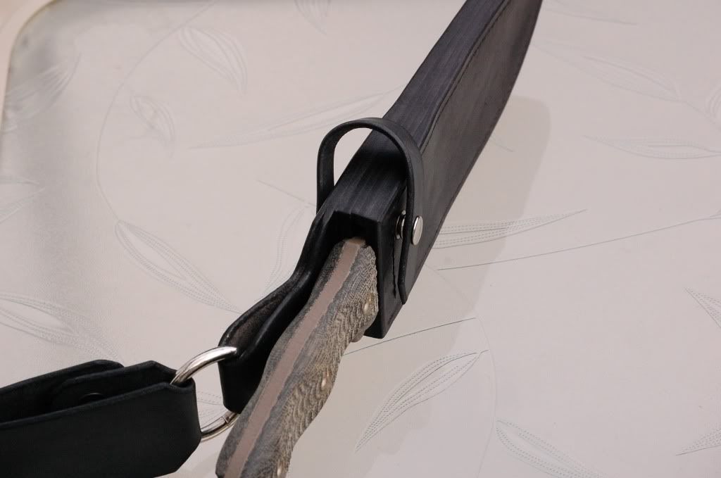

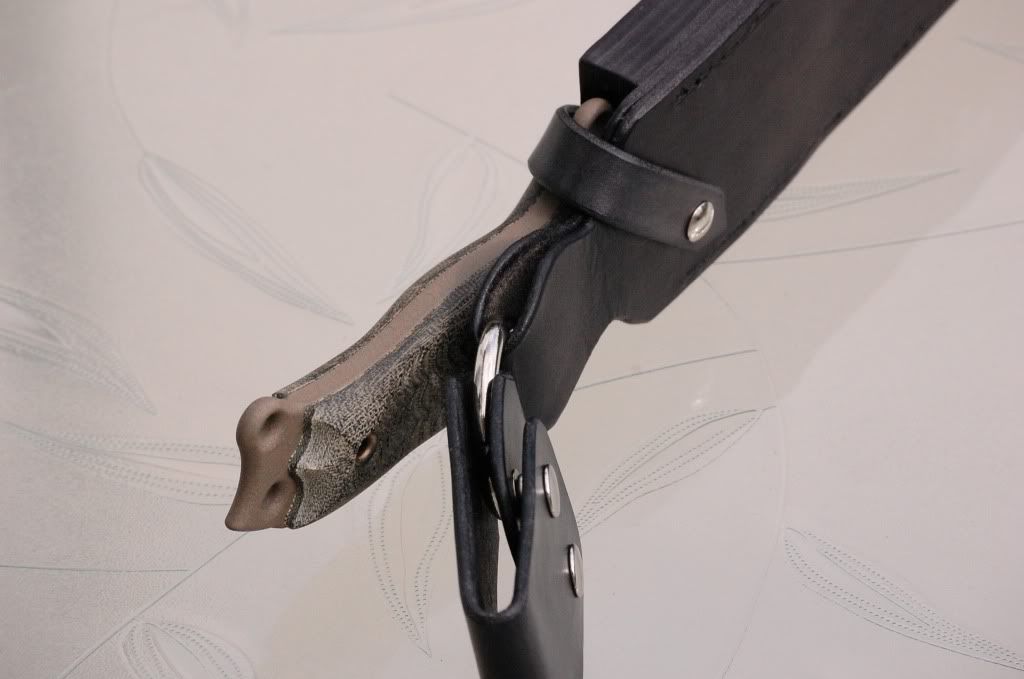

Here's one way to do it, which I "borrowed" from Chuck at Chuddy Bear Sheaths. The strap is attached to the back with a Chicago screw, which makes it easily replaceable, but it also lets the strap swivel out of the way of the blade when opened. I've gotten used to just rotating the strap down and out of the way automatically when I unsnap it.
It also lets me swing it around to the other side of the sheath if I want to, for times when I may be using the knife a lot and don't want to lay it down, but don't really need to strap it in.
If you're making a strap that goes all the way around the handle, Dwayne Puckett's idea, shown in Nick's tutorial, works well. It stays out of the way better than others and can be replaced if it ever does gets cut.
