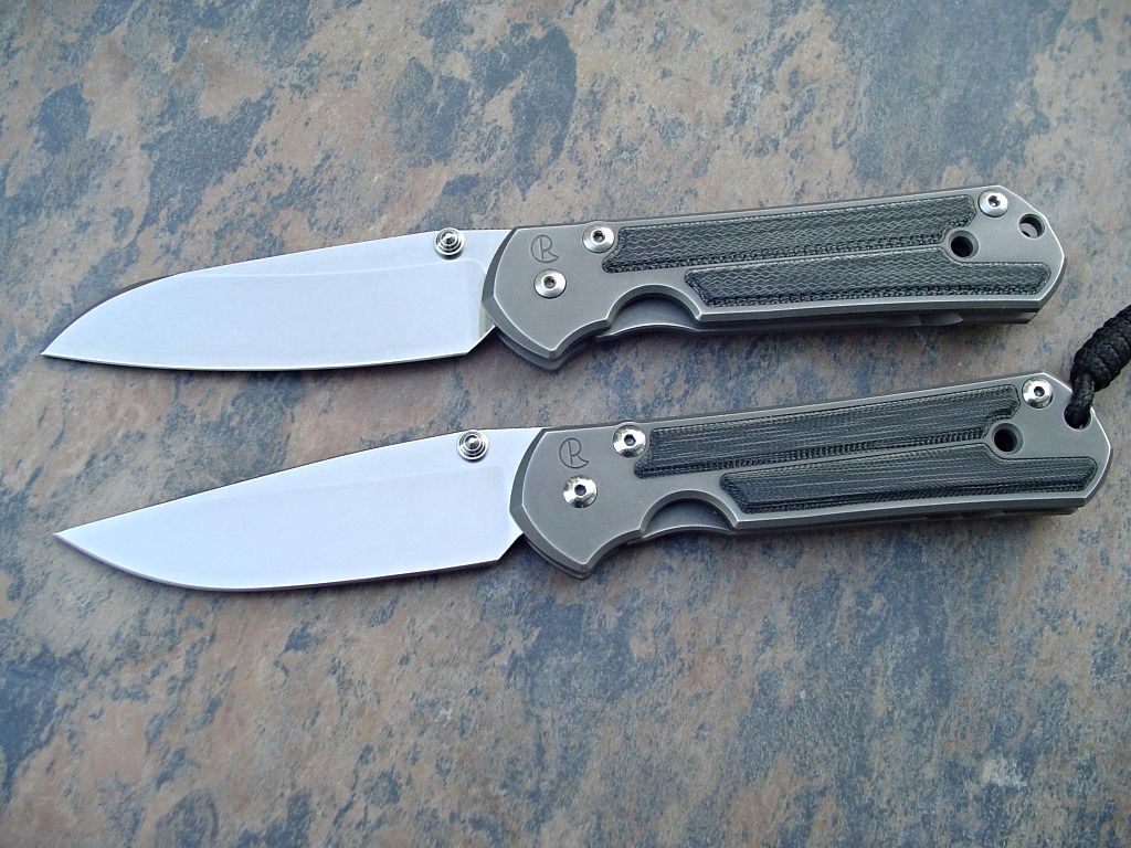

These two were "scotch brited". I used a combination of scotchbrite pad, sand paper, and steel wool. My advice is to start really lightly and slow...it doesnt take much!
These two pics are one i did a while back. It was my first try...again, a combo of all 3.
