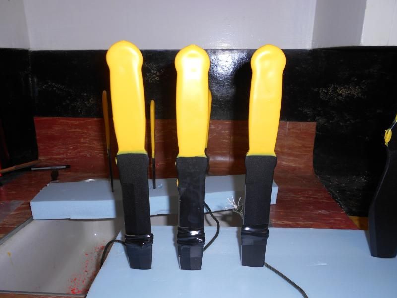

I don't know about anyone else here but I like the handles of my throwers to have a bit of color on them. To me, it makes the rotation of the knife a lot easier to pick up in flight for one, and a bit easier to find errant throws for another reason! Up until today I used a bit of bright spray paint on most of my throwers, easy enough to touch up but not very durable. Bright colored tape was another option I tried, but did not like the sticky residue it tends to have. I picked up a can of Plasti-Dip at my local hardware store for about ten bucks.
I did all ten of my throwers today:
(4) Cold Steel Sure Balance throwers
(3) Cold Steel True Flight throwers
(3) Gil Hibben cord wrapped throwers sans cord.
I used up most of the can, each knife got four coats of dip 30-40 minutes between applications.

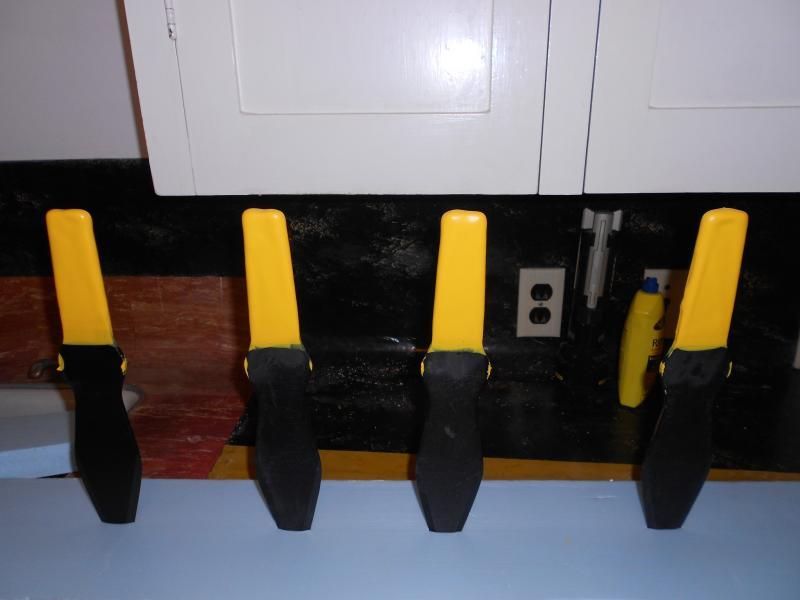

Sure Balances.
True Flights with Hibbens in the background.
I really like how it makes the knives feel in the hand! I am going to let them cure overnight and give them a try tomorrow, curious to see how the plasti dip will hold up!

They have taken a few cuts and dings from other knives, and a few cracks on the pommel from hitting pommel first, but so far are holding up really well. Getting a better target set up so I can throw at multiple targets will save a lot on wear and tear. Visibility is not bad at all in green grass, but now that the leaves are falling and changing colors it takes a bit more to see them, but still not bad. If I decide to re-coat them I plan on trying DuraCoat or Cerakote to see how it holds up, but for now the Plasti Dip is holding up pretty well!
As far as grip goes it does not seem to affect my spin throwing at all, no spin seems more difficult but that may not be a fair opinion as I'm still new to no spin and kind of suck at it yet. No spin is fairly easy with the sure balances after they were dipped, at least the same as before I dipped them. My Hibbens on the other hand, seemed much easier to no spin throw before I dipped them. Time and more practice will tell, but I may peel it off the Hibbens in time.

Peeled the dip off of the true flights today, not holding up anymore. Back to the drawing board for high visibility handles.:(
