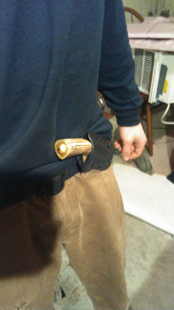

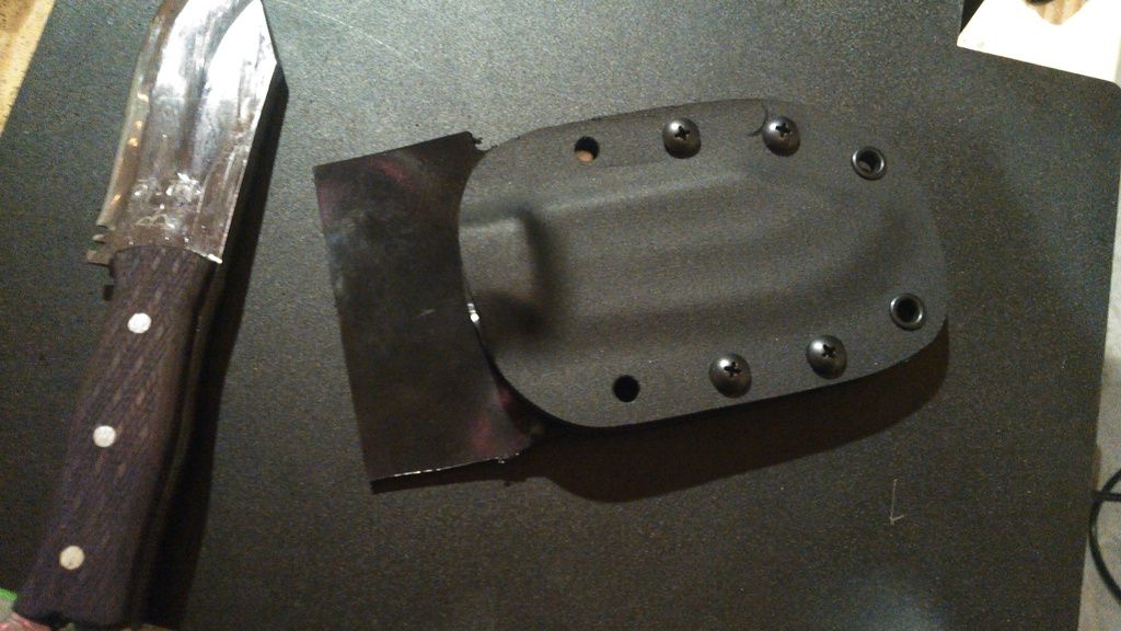

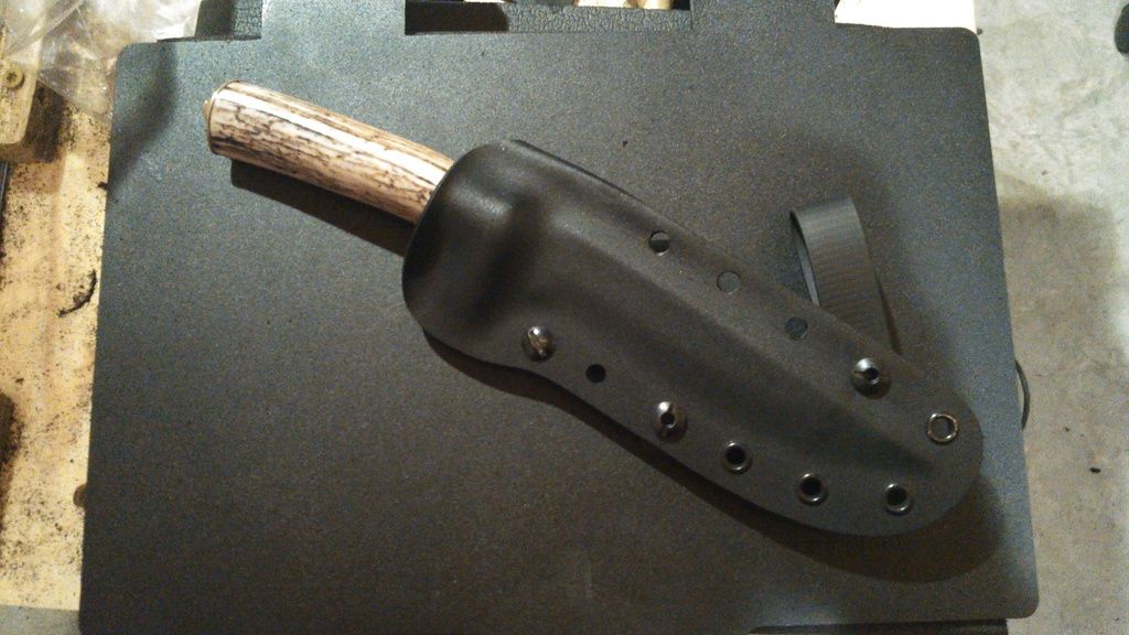

The Western sheath was pretty easy to complete, once I realized there was in fact room to drill holes all the way up the spine. After that it was just a final clean-up of the edges. I added a retention adjustment screw which will take the sheath from perfect EDC security with the screw out or loose, all the way to near paratrooper securedness. There's a satisfying "click" as you resheath the knife. The IWB loops are set up more like standard belt loops, currently positioned to carry the blade at a slight angle. I was able to get the knife to ride fairly close to my torso, though I suspect vertical carry might be the way to go.
Next I moved to the Bowie. My phone was dead and charging for most of this, so there aren't as many pics as I would like, but that's OK. I think y'all got the idea by now.

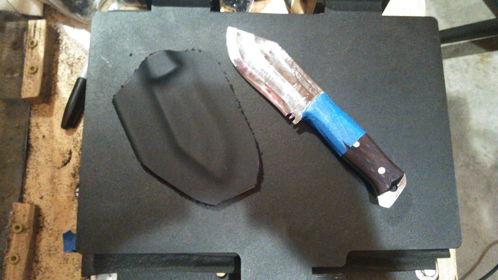

Long story short, 4 attempts and an hour later and I finally got a usable press.
And by "usable" I mean "freakin perfect"

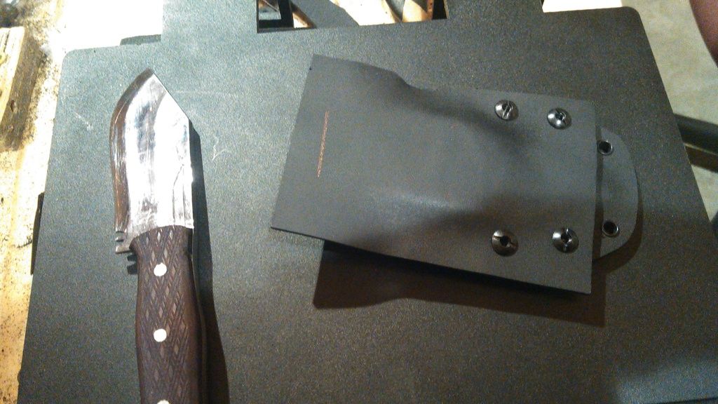

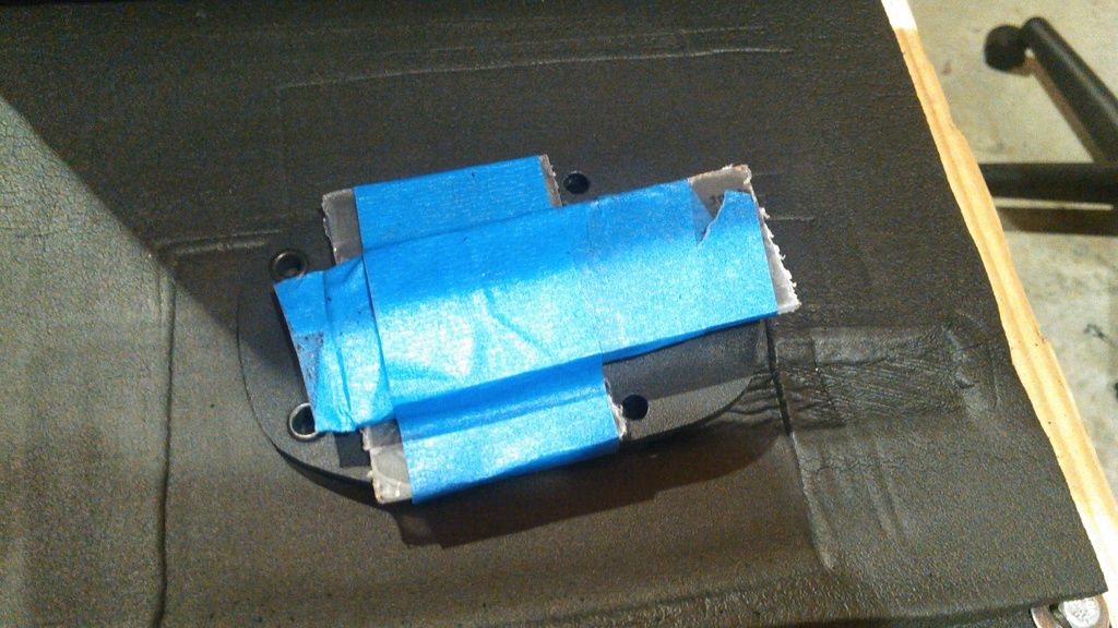

After that was all drilled and riveted, it was time for the next hard part: the clip plate. First step is to mold a piece of kydex that will go up and over the bump of the handle, have a flat piece where the clip will sit, and also, ideally, make the knife sit relatively flat against the body. Basically i have a couple pieces of scrap plexi and acrylic that I have arranged so that there will be a shaped piece of kydex that also sits flush with the holes. I'm not really sure how to explain it, but it was just a bunch of trial and error when I made mine, then I was smart enough to keep the little jig.
After the initial form, there's a whole lot of tweaking and adjusting little parts with the heat gun, then eventually you can mark and drill holes. This is my first time attaching the plate after drilling. Got lucky, it lines up great. You can see the line I drew to mark where the top of the clip will be.
This is from the front.
I didn't take pics of the last step, but it essentially involves creating two slots in the plate for the clip to sit in. I use a dremel with a router bit for that. It can be a little tricky to get the spacing just right so the clip doesn't wiggle around at all, but I was able to pull it off on this one. You can sometimes get the clip to click into place, which I did in this case, and then attaching the plate to the sheath also holds the clip in position.

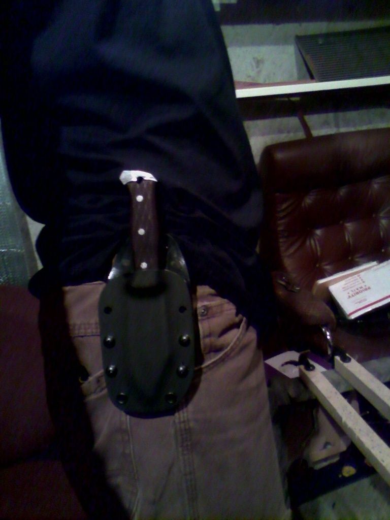

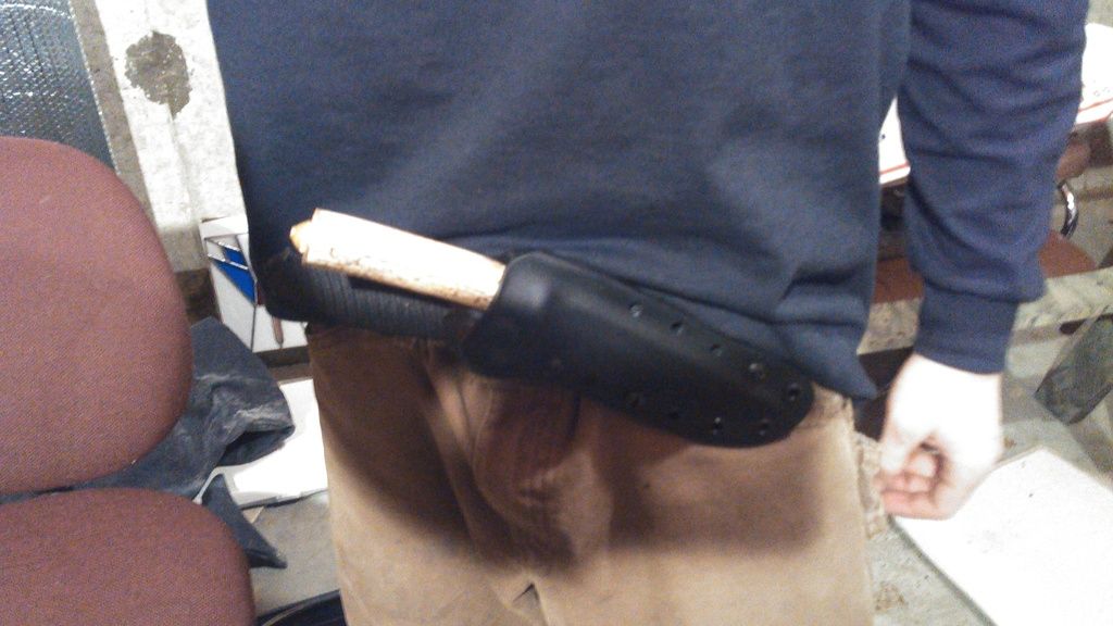

Here's the Bowie sheath compared to mine. Mine is the one with the worn rivets ;) haha and also the longer handle. Didn't put a retention screw on this one like on mine because, well, the retention is better already. If anything, it's on the tight side. Drew a bunch of times, always came out fast and easy with the sheath still attached to my belt.
And it rides perfectly. Didn't even clip my funny bone like mine does!
