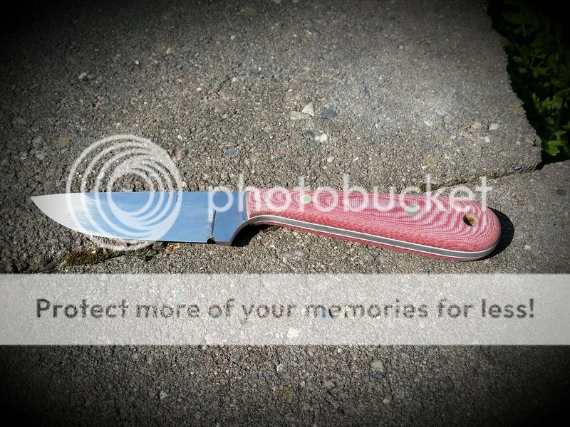

I got this one finished with white fiber liners and red linen micarta scales, I think it turned out pretty good?
yeah, I've always like the red and white combo, it just looks classy, like a red and white Bel-air!
