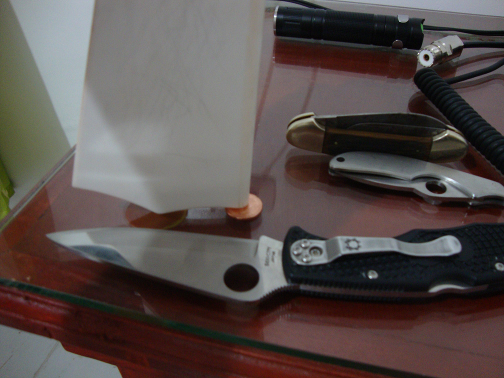

This is an update to Mr. Glesser's awesomely generous gesture to me, a few months ago. When I posted that I had to field sharpen my knife, he immediately responded by sending me a golden stone to play with. Thanks again Mr. Glesser!
My impression is that the edges of golden stone is just a bit coarser than the spyderco brown sharpmaker stones. Perfect for that utility edge! Now my knives are just as sharp as when I'm with my sharpmaker.
The golden stone has a built in 20 dps angle when used according to instructions and I wanted a bit less than that and found a "fix" that works for me. I'm not so good with words when trying to explain this but the golden stone has a sort of point in the middle that acts as a pivot to tilt it from side to side to give you that angle so you can use it like a sharpmaker. I used a coin to lower the angle a bit. I'd be happy to answer any questions for any clarifications.
Excellent story that reflects what is becoming so evident to a new member, it certainly is a community here. Thanks for posting
Looking good! I like the penny trick, good idea.
My subjective view is that the lowering of the angle makes a big difference in felt sharpness. The edge just feels more sticky and seems to bite into the skin of my fingers more than from the 20dps without the coin. I don't have any idea of what the angle is now though.
We'll send a fixture to you that converts the 40 degrees to 30 degrees. Still refining it.

Did you or will you guys ever make a fixture like the sharpmaker case to house the 701's in for the correct angles, 30 and 40? I am new at sharpening so looking for a gig/fixture! Or maybe one for the Double Stuff!
Thx.
The plan is that the Golden Stone will be coupled with a CBN stone (the old duckfoot but in CBN) with fixtures for 30 degrees and a fixture for vertical position at about 15 degrees. Then we'll figure out what to put it in, then make a video. It's really an "afi" stone.
