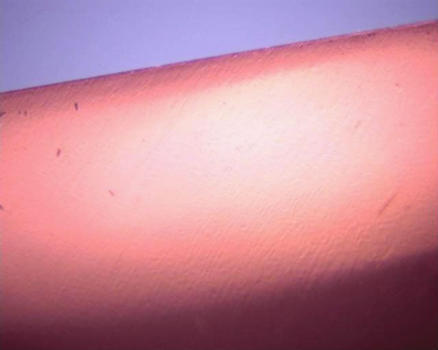

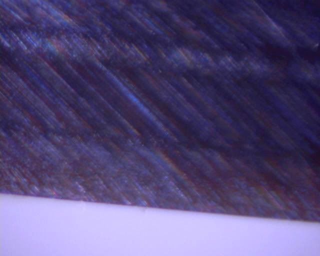

Got my new toy today, QX5 digital scope. These things were in stock for less than a day at digiblue, they must not make many of them these days. Looking at some steels finished with a nakayama kiita, Japanese natural stone supposedly in the range of chromium oxide & similar (30,000+ grit when the slurry breaks down) The images are 200x
S90V mule, finished on the kiita
M4 mule, also kiita
Vintage razor with what seems to be ruined steel, it is constantly microchipping, no matter how I finish it. There was a lot of old corrosion at the edge, so I think this full hollow just doesn't have anything left. I rust blued it to try to slow things up, but the damage is already done. Anyway, I just want to show how the bevel looks, that's the fuzzy finish from the kiita
Country Cousin in D2, kiita
vintage razor finished on kiita then cro, needed a little touch-up cause I didn't oil it
52100 mule finished with coticule, translucent ark, & cro

Looks a little coarse for 30,000+ grit, What range do you think it was in for your samples?
I couldn't say, haven't looked up the proper pixel counting and such to measure scratch size. I just wanted to make sure the stone wasn't horribly off and I got hosed on the purchase. With the natural stones, you never know what you will get. Plus a couple of those steels are pretty wear resistant and probably could have used many more passes. These natural stones do not mirror polish like CrO can. The finish looks like a bead blast because of the way the stone abrades the steel, which I think the King showed best.
This site has some pics, though he says they are only 25x. http://www.thejapanblade.com/test27.htm It's interesting, because I would have expected to see something less scratchy at 25x from 16 & 30,000 Shapton. I don't know if the QX5 is managing true 200x, being intended for kids and surely all plastic lenses.

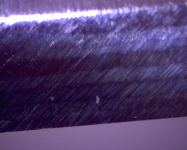

these are pics of the same edge, the first two are the same spot actually. Just see what changing the angle does, lighting and magnification are the same.
Here's a few pic's you might be able to use for comparison. Compared to other stones how sharp was the finished edge?

200x DMT EEF, S30V millie
400x
VG-10 2000 grit 3M sandpaper, stropped on a hard felt pad W/1 micron diamond spray about 20 passes per side. 200x
Gotta tell you, until I break out the postal scale and thread again, I'm having trouble telling. I thought straight shaving was going to be a good test for the high grit stones. Since I figured my sensitive face and kinda coarse whiskers would give me a practical use for keen edges, it seemed like the next step. Add in the braindead ease of sharpening a straight - no pressure, angle guide built in, I thought I was golden. Until I found out through reading and experimentation that I could get a comfortable shave at 4000 grit/3 micron, or off a coticule, which has garnets up to double digit micron size.
Still, the M4 got sharper than the S90V for the amount of work I put in, but it's pretty clear that everything could use some more time and refinement.
Anyway, I honed out the chips in the old razor again (those so obvious in the 3 comparo pics), did the Chinese hone (~12,000) followed by the kiita, then went back to the translucent Arkansas followed by CrO... and it must be my eyes and the cheap scope, but I had trouble seeing a significant difference between the results. Most all the chipping is gone again, too bad it only lasts for a few shaves (except for where the corrosion makes it impossible:() I think another reason is I believe the scratches get too fine to show up past ~one micron because of the wavelength of visible light and the size of the scratches.
Lighting is a very tough factor, I have to use high power flashlights on either side to get some of my pics. This next one is CPM-D2 after a lapped UF ceramic and 1 micron compound, sometimes you have to use some incandecent light to get the right look.
