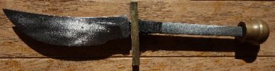

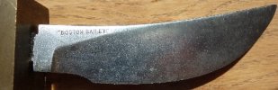

Hello,
I am new to this site and hope that someone may be able to shed light on a Randall knife.
Approximate dimensions: 4.25" blade & 9.5" Overall length. This appears to be similar but is not the same as a model 22 and I would guess that it is older than a model 22 as I understand that was introduced in 1972.
Questions:
What model is this?
Approximately, how old is it?
Who is/was Doctor Bailey?
Thank you,
Randy

Hi Randy, and welcome.
To me, it appears to be an unfinished Randall KIT knife ordered by, or for Dr. Bailey. Name etched Kit knife blades were not typically blade etched to indicate it being part of a Kit knife.
Hope that helps
Thank you for your response.
During which years, did Randall offer kit knives and which models were offered as kits?
Attached is an image of the rat tail without the end cap bolted on.
