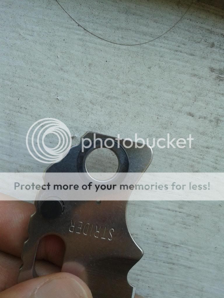

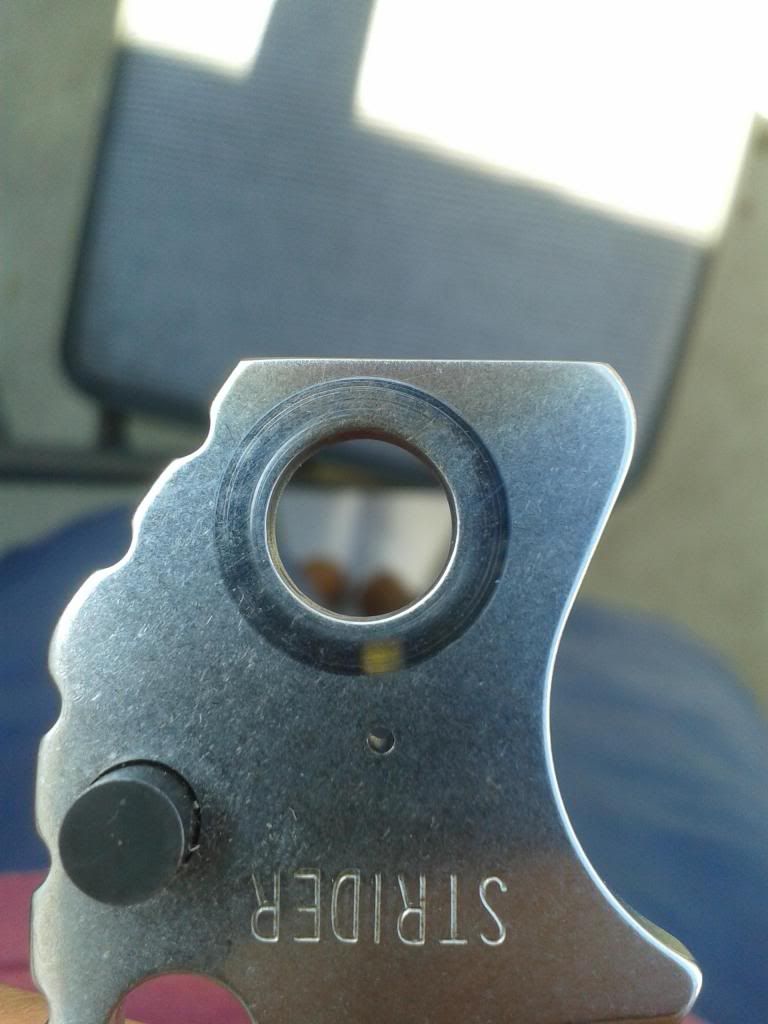

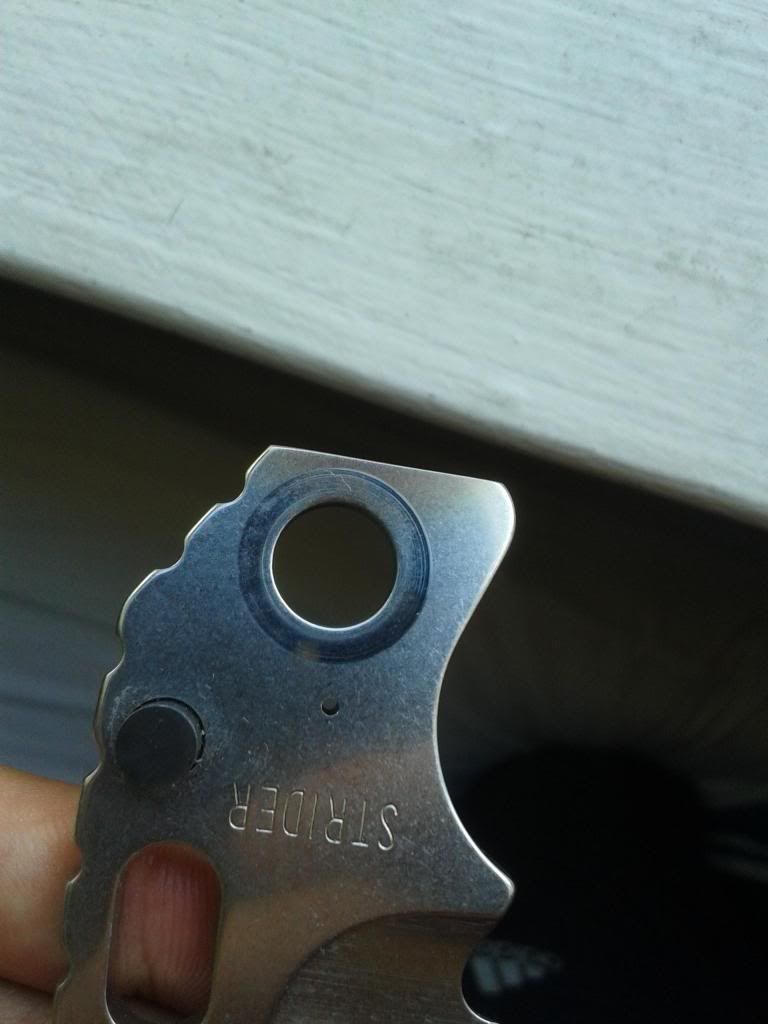

Took part my strider smf after a couple of months to clean it and noticed this slight discoloration on the very back of the blade. Any ideas to what it is and what may have caused it. COuld it be rust? Have kept it very well oiled so have no idea how this happened.
Looks more like heat discoloration, odd that it would be on the blade after stonewashing however. Might have been from grinding the locking interface after finishing?
Doesn't look like rust to me.....but I can't be sure. It would be very odd to get rust under moving parts and not anywhere else. When I get rust on my knives it it usually near the pivot but never under the washers.
that was I was told by someone else as well but I have taken this knife apart many times before and this is first time I've seen it which is why i found it odd. I also dont think its rust but couldn't think of what else it might be...
The way it radiates from the lock-tang makes me think the same thing. I've seen it before, but I can't remember if it was on my own SnG or in pictures.
Now, whether that is a problem or not... I don't know.
P.S. - Nice pictures. :)

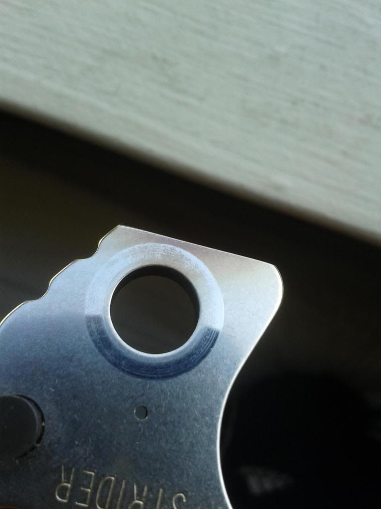

Doesn't look like rust at all. Have you tried metal polish to remove?
You should be able to ding MAAS or maybe even flitz at a hardware type store.
Just a thought. Does that knife use bronze washers/bearings in the pivot? Just wondering if that discoloration might be some of that (bronze) wearing off and/or embedding in the steel. Color looks about right for that. Doesn't quite look like rust, to me.

Yes it does use bronze washers. Hmm didn't think of that! can bronze washers wear away and discolor a much harder steel like s30v tho?
If the washers are doing this, it would be the bronze being worn away, and it's resultant bronze 'dust' getting embedded in the surface of the steel. The washers wouldn't wear the steel away; it's much too hard & abrasion-resistant. The washers should wear, and not the steel; it would be self-defeating the other way around. I think part of the 'self-lubricating' nature of bronze washers is due to some of it's material being able to slough off this way.

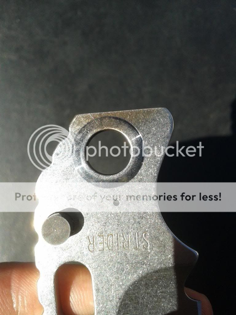

The other side also has the same discoloration, just not as prominent. But if it was heat discoloration it should have been there from the beginning right? This is the first time I've seen this and I have taken it apart many times before.

That most certainly looks like the steel was getting a little hot when grinding the face of the lock. Sometimes these colors wont be as noticeable and then after using a cleaning solution like windex and removing oils it will be more apparent. You can even see where the washers riding on the face of the blade have started to remove the coloration. I would be willing to bet you just didnt notice it. Judging by the color its nothing to worry about. There is no burnt colors or blue/purple notes. Once you start getting to that color the hardness can be compromised.
