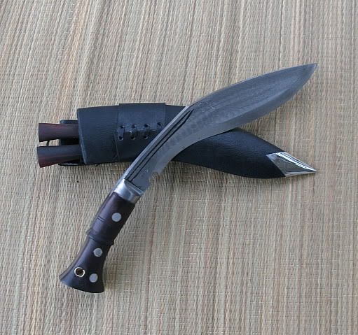

This is a pic from Wolf_1989's.
You seemed to caught on the virus of General Singh. Welcome to the club!
This was a 15" i saw last year.
