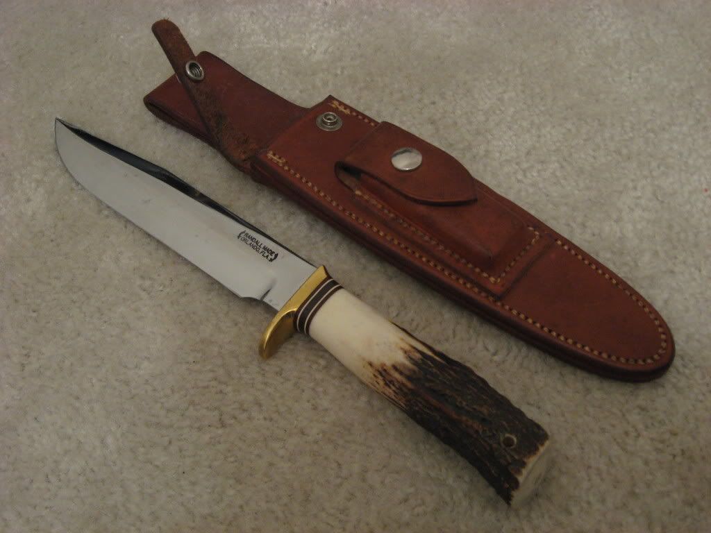

Please help me ID this Randall
Jun 28, 2006
90
I purchased this recently for a pretty good price.
It's my first Randall, so I don't know much about the brand. The sheath is marked 2-7, but I'm not sure that is the correct model number.
Any information somebody might be able to give would be great.
Thanks for any help!
tmix
Looks like a Model 5 Camp and Trail knife.
Hard to see the spacers in your picture. If there are 7, the knife is probably 1972 or earlier. 7 spacers = burgundy-white-burgundy-blue-burgundy-white-burgundy, with the 2 outer burgundy spacers thicker than the others. The blue is often faded.

Yes. That sheath is for a Model 2 "Fighting Stiletto" with 7-inch blade.
value
The Model 5 costs $325 new, plus $50 for stag handle, $15 for wrist thong, and $15 for thumb notches on top of blade, so $405 total. (http://www.randallknives.com/catalog.php?action=modeldetail&id=41) Not sure what you would get if you sold it, with mis-matched sheath, and what appear to be scratches and discoloration on the carbon steel blade.

Good question Dan, but if I’m not mistaken, that knife actually has a six inch blade. As CnR stated, the knife is probably 1972 or earlier, based on the seven-spacer stack that was discontinued by the end of 1972; but, there are other clues here too – specifically the shallow blade choil, first seen as a standardized characteristic around mid 1962; the thumb notches on the blade spine, first seen on this model with the introduction of the ‘Bradford Angier’ variant in 1964; and most importantly in this case, the blade grind...
Sometime around, or soon after, 1970 the overall appearance of the blade grind on most Randall knife models changed quite dramatically. Gone were the gently radiused rolled edges on the primary bevels, replaced by the very sharp angles seen on this knife. If the blade finish on this knife was ‘mint’ I would be concerned that the knife had been shop refinished at some point in the recent past – but, the light use and sheath scratches apparent here lead me to believe that it is probably the original blade grind.
If that is indeed the case, then IMO, the knife is probably an early 1970’s production model. With regards to the sheath issue: we had a mid 1970’s Model #1-6, sans sheath, that was mint; I looked for a sheath for over two years before settling on a new (current production) Sullivan’s sheath. We paid $500 for the knife and close to $50 for the new sheath. We later sold the knife on eBay for roughly $550 after expenses...YMMV
Agreed, as Mr. Sams said, the knife alone is probably worth close to $500 – but, the older tight-stitched Johnson Roughback sheaths for knife model (the same sheath fits the more popular Model #1-6 fighting knife) have recently sold in the $200 range; the same for the correct white Norton ‘Bear Brand’ SP-13 sharpening stone. So, if you can even find the right sheath and stone (hopefully together), you’ll probably end up paying though the nose for it...
Again, it's nice older Randall knife, but not highly optioned or particularly rare by any stretch though. FWIW, my post above is intended to advise a potential buyer of what they’re getting into, before they get into it...not to run down the knife.
Hope that helps.

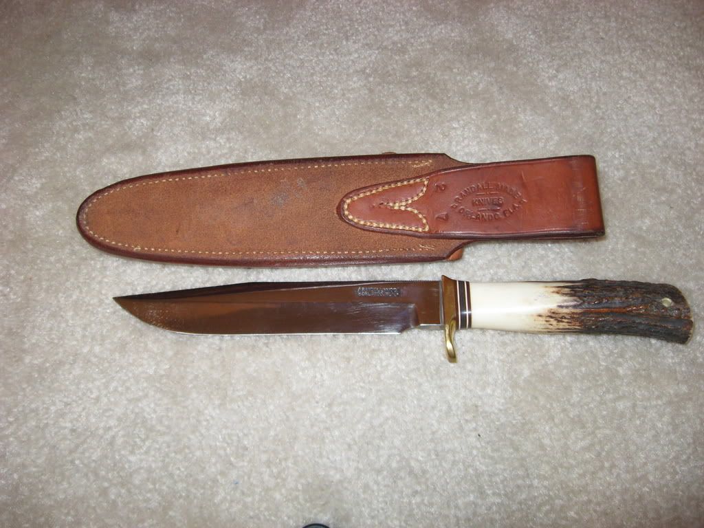

That's a great knife! The stag is exceptional. I agree with Sheldon that the blade is 6". I have a period sheath for it (Model 5's shipped in Model 1 sheaths). It's never had a knife in it, but it has some mildew. If you're going to keep the knife and not sell it I'll swap it for your 2-7 sheath. I also have a period 1-7 sheath in the event your knife is 7". Just let me know.
Best,
Ron
Let me measure the blade again. I measured it once awhile back, I'm pretty sure it's a 7" blade, but I could be wrong. If it's a 6incher, we could possibly work something out.
I'll try to take some photos next to a ruler.
Like I said, I have a 1-7 period sheath as well. There's still the pregnant question to be answered: Do you plan on keeping the knife?
