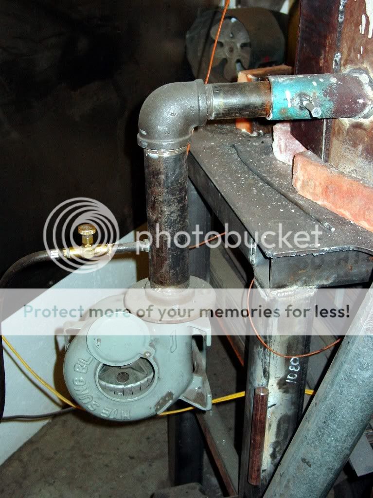

Dear all,
I am studding burners for a few days now, and I'm having no success with my burner building. I'm facing some troubles and I will be thankful if it will be possible for you to give me some advice. Please find enclosed some picture of my setup: The pipe dimensions are written on them (a bit too small...). The gas I'm using is normal cooking gas (butane?) as I don't have access to propane, which I understand is the popular one in the states.
As you can see, I use a blower; the main problem at the moment is that I can not get a stable burners flame, more a regular cooking flame (that sometimes jump out of the forge opening). There is no "dragons breath" when I ignite the burner, I mean that the flame is just not strong enough. I tried everything regarding regulating, fine tuning and so, but just can't get the burner to give a classic blue loud burner flame. Often the flame that I have tuned (after hard work...) shuts off without any reason, and often it is burning in "pulsing", i.e. pulses of regular "kitchens cooking flame" that beats out of the opening. Sometimes I can smell the gas, and I understand that it is not totally burned.
1. Is this butane gas ok or must I switch to propane?
2. Is it possible to combine a venturi system into this blower setup?
3. Shell I drop the blower idea and switch fully to venturi?
I thank you very very much in advance and appreciate your time - Michael.
Looks like it may be too small of a fan, or the fan may be restricted too much by the adaptation to the pipe. I'd eliminate the top bell reducer, run that 1-1/4" pipe back through a 1-1/4" tee and adapt that to the gas and air, without bottle-necking the air by adapting small.
How are you regulating the gas? I don't know about butane, but with propane and natural gas a blown burner does not need a small, precision gas jet. You will need to regulate it at the tank, something more sophisticated than just a valve. It sounds like your burner is running way fuel rich, so I'd work on increasing airflow and regulating the gas. Once you have high volume airflow, then you can regulate that by putting a 1-1/4" gate valve in line or even just putting a swivel choke plate over the blower intake.
Also, I'd suggest using a 3/4" burner tube, but it looks as if your forge shell is fairly committed to the size you already have.
Your burner tube is still threaded; I'd cut the threads off evenly and then de-burr the inside of the pipe. The tube looks a bit long, anyway. The result should be a more stable flame.

Thanks guys; Do you think that a ventury system will be a better solution? Or can I combine between the two?

I'm not trying to be too blunt, but, there is more wrong with that burner setup than right...at least from a usability standpoint. The obvious has already been mentioned about not enough air. That is due to the incredible restriction being placed on the blower. Next, about the blower. That is what is commonly referred to as a "shaded pole" blower. Those type blowers do not work with back pressure....and due to the restriction in that setup, I doubt your getting 1/10 of the air flow that blower is capable of...and unless you build a gradual reducer, it simply won't work for you. (Shaded pole blowers are designed for use in situations with zero back pressure.....and if/when back pressure is present, it restricts the air flow, and will often burn out the motor in a short time)
The next thing that I see that raises a red flag is how small the actual flame tube is. I'm guessing that forge body has and ID of 8-10"? For a castable forge of that size, you need at least 1 1/4" dia (and preferably larger) "burner" tube.
I don't know how to say this without sounding upity, and it's not meant that way, but why all the different sizes/types of fittings? Forge burners are all about K.I.S.S. The more you overtake the plumbing, the easier it is to stop up the drain, and generally the less efficiently they function.
Next, I would recommend operating the forge on Propane rather than butane.....Butane is far more expensive, and produces few BTUs compared to propane.
Here's my suggestion:
This is the burner on my welding forge. It's been in use for about 20 years, and works very well on about 4-5 psi of propane. Starting from the bottom....a blower designed specifically for forges (available from Blacksmiths Depot), connected to a 2" pipe flange. (This blower is designed to be used in a back pressure situation) The pipe flange is connected to a piece of 2" X 12" black iron pipe. That is connected to a 2"x1 1/2" 90 degree elbow (also black iron). The next piece (at goes into the forge) is 1 1/2" x 12" black iron pipe. The gas inlet is drilled/tapped into the section of 2" pipe near the blower.
The important parts of this design are the blower....it's designed to work with back pressure. Also, the pipe necking down from 2" to 1 1/2" at the elbow, this changes the velocity of the air/fuel mix, causing the mixture to "tumble", which achieves a better air/fuel mix before hitting combustion.
GET RID OF THE GALVANIZED STUFF! NEVER USE ANYTHING GALVANIZED ON YOUR FORGE...IT'S A SERIOUS HEALTH HAZARD
Whatever you do, realize that your burner components need to be matched in size to your forge, and forget all the "bells and whistles" when it comes to a forge burner. Simplicity is the key to designing a trouble free, usable forge burner.

The burner tip has 3" of concentric pipes inside the main 1 1/2" pipe. There is the 1 1/2" pipe, inside that is 3" of 1" pipe, inside that is 3" of 1/2" pipe, and inside that is 3" of 1/8" pipe. It helps a little with the flame pattern, but it's main function is to tone down the roar the burner produces without the concentric pipes.
