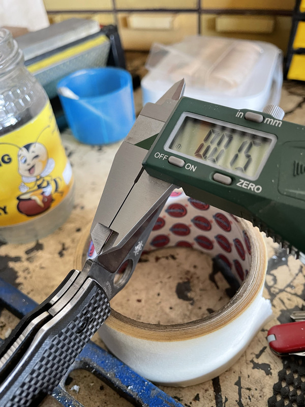

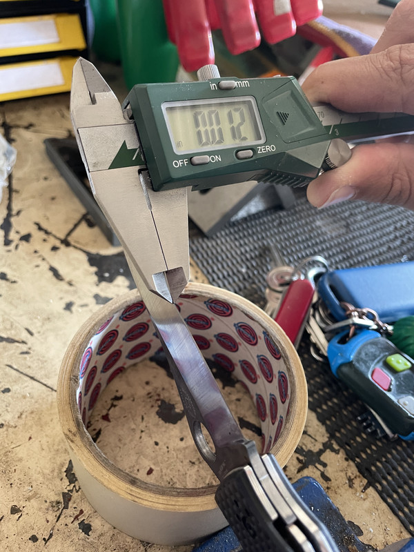

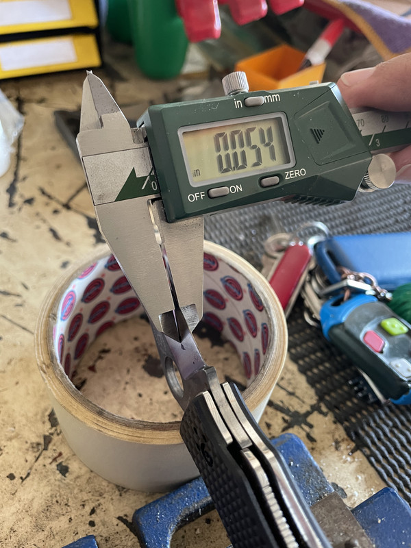

I will have to do some measurements for you but it will have to wait until the weekend when I can get the callipers out but yes I did regrind mine quite thinner.
I did some experimentation with M4 at low angles many years ago that led me to do the regrind.
Mine is 0.012-0.015 thin behind the edge and 10mm up from the edge thicker than the original at 0.054 of an inch.
Quite surprising to see throughout the years it is now very similar to that of the original.
I measured the amount of steel removed compared to my original I still have and there is around 1.5-2mm of steel that has been sharpened off.

Thanks for your work. I measured again because I could not believe that big difference at the 10mm measuring point. I repeated that and precisely measured 42 thou. 12mm behind the edge (imagine that I ground 2 mm off the edge) it stands 52thou. That means that our two knives have quite the same geometry, doesn`t it? If yes I will no longer hasitate to use my GB1 harder ;)

Seems like it. I was surprised. Thought mine was thinner than it was.
