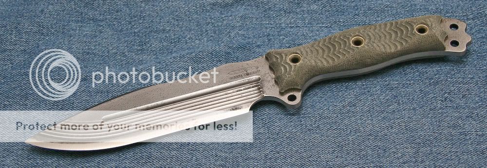

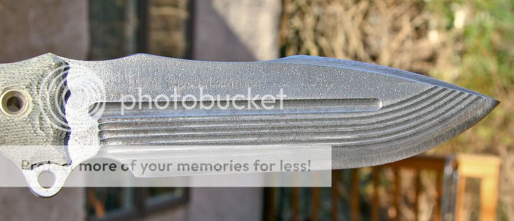

POINTMANDDT, Chuck wouldn't risk his very solid reputation trying to pull one over on you. :) I also just sold one recently... But before I did, I wanted the Buyer to know what exactly the Comp Hell Razor that I was going to sell him looked like, and explain exactly why it looked this way. Others have already explained why yours looks the way it does, so I'll just post pix of the one I just sold, so you can see the similarities. The one in these pix is also new & unused/unsharpened. In the pix, you can see exactly where the de-carb ends and the real INFI begins. Note that the oxidation stops dead at this same line down near the edge where the grinding of the edge passes through this thin layer of de-carb and into the actual INFI steel, just as it does on yours. :thumbup:

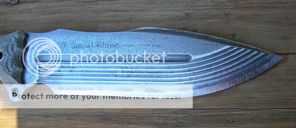

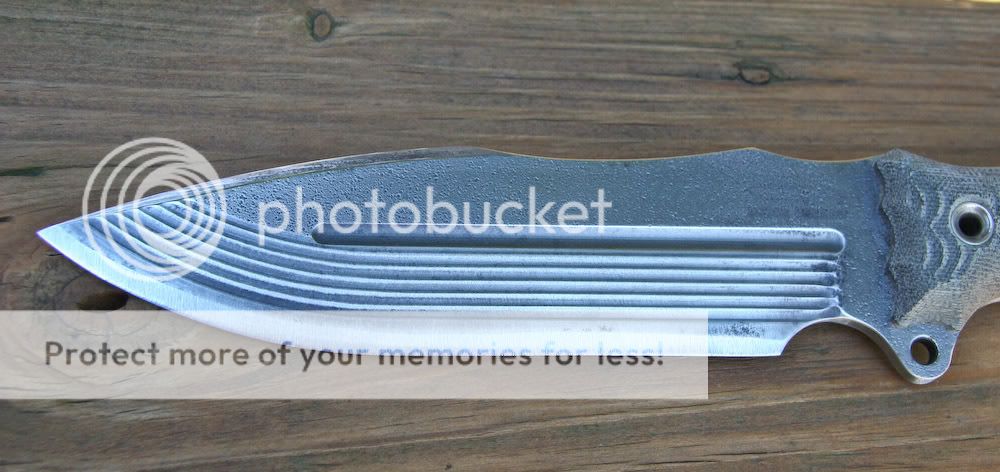

These next 2 pix were taken just after working at removing the rust on top of the oxidation spots for a few minutes with 1500 grit sandpaper and Mother's metal polish for the new owner. I did what I could for him to make his task easier, then sent these photos to him with an explanation to show that the rust will not pit the INFI below the de-carb layer.
Seriously, I looked at your pix, and yours does look to be new & unused and also unsharped. Enjoy it, as it's meant to be used hard!
