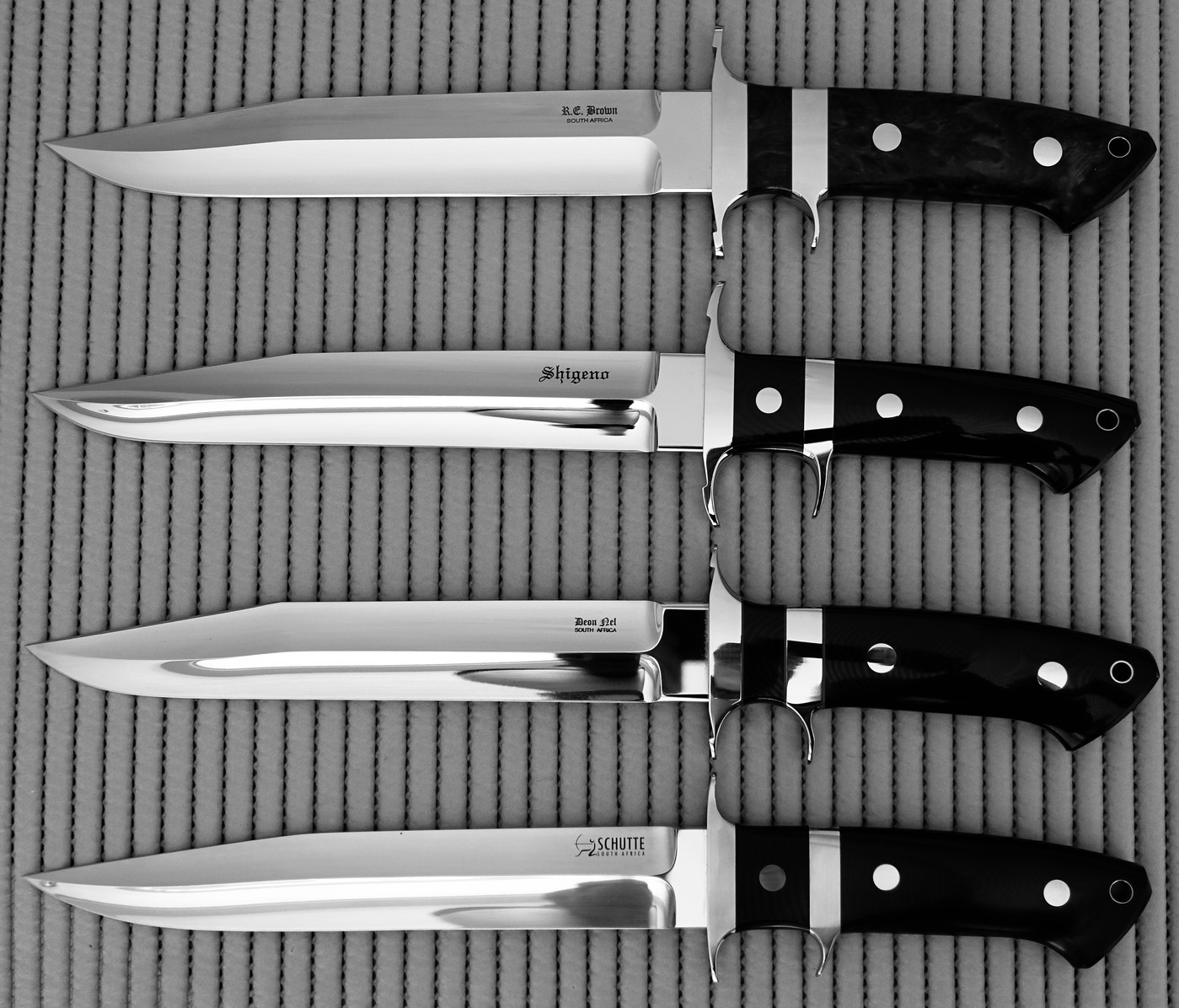

I’m starting to get really interested in this style of knives and starting to put together some ideas for a design I’d like to have made.
Please post up pictures of your sub-hilt fixed blades and a bit of info about them! In particular I’m interested in any designs that might diverge from the traditional Loveless-style fighter blade shape, but those are still more than welcome - I’m not loveless of some Loveless knives 😉

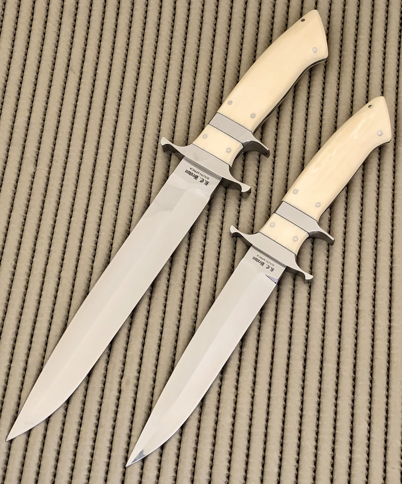

Gorgeous blades! What’s your preference (if any) between having a tighter, more rounded space around the index finger vs the wider, more squared-off style?
Thank you, I'm a bit of a Loveless nut!😁
To me what's important is that it's comfortable. Whatever the actual style of hilt you go for the finger must not be cramped in the space.
Rounding off the inner tang can make for a very comfortable grip but you still need sufficient space for the fingers between the guards.
I think you need to look at the overall design of the blade and build the sub-hilt accordingly. If you look at Dudley's Lurquin (above bottom photo) you can see how Sam integrated the sub hilt in a very organic way into the design. It just looks right.
