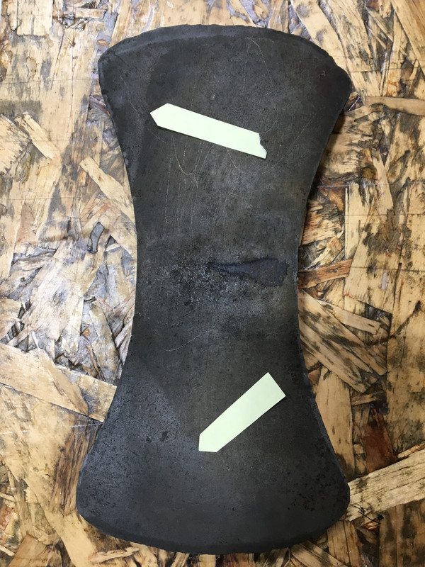

So a coworker has a double bit Plumb marked axe. He gave it a vinegar bath and there is no temper line.
The head does not look to me like it’s been ground back to nothing.
Did Plumb use supper steel that did not need tempering ?
I can get pictures if necessary. But I kinda figured this is a simple question for the more experienced.
Thanks

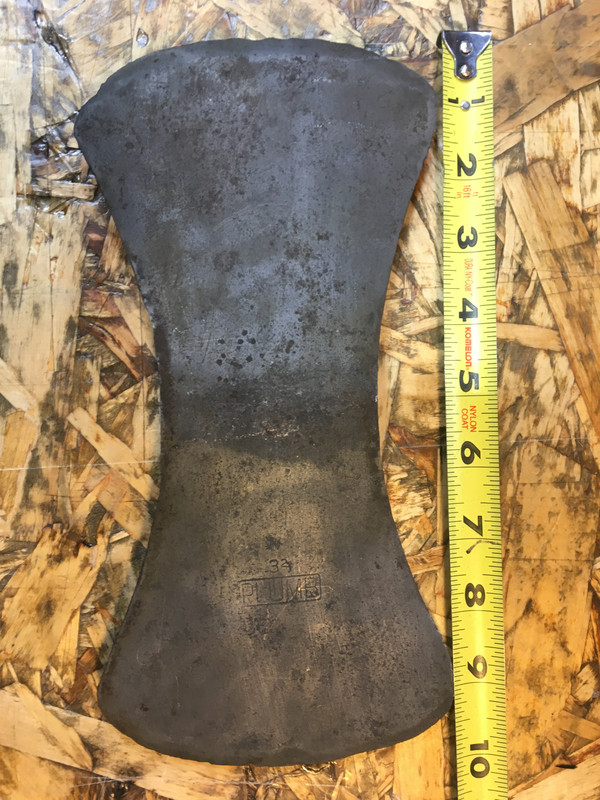

Edit: ok now with photos. And weight

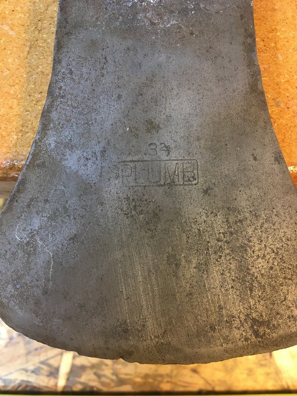

Stamped 3 2 (3 1/2 lbs) weighs 3.40 lbs
Length of bit is 9 3/4”
There is a hardening line in the 2nd picture. Had this head been somewhat cleaner (wirewheeled), you'd be able to see it more clearly.
I see what your referring to. But that line does not meet up with anything on the other side. Actually there are other “lines” on the other side.
This was the first time he’d ever soaked anything in vinegar. I think the lines seen are from the head not being fully submerged. I’ll post a photo of the other side.
agreed - you can see in the second picture the steel closer to the bit has a different quality to it, it reflects the light a little different.
those other strange lines you are looking at can't be the temper lines.
can't remember if anyone else suggested that it maybe didn't soak long enough for the bit to get dark? takes a while.
If these are temper lines then Plumb should have sold this one off so some other department store, under another name.
They probably would've rejected it earlier through the manufacturing process :). There's no way for the top one to be a temper line, you're right.
Survivor45, the only suggestion I have is a longer soak indeed, as my esteemed colleagues said. Then, I'd wirewheel it, to make everything even more obvious.

Ultimately...as Square_peg said...a file should tell you everything that's needed to know in practice :).
Agreed also on the file test. I only have one plumb, but the bit is very hard and my old file skates right off.

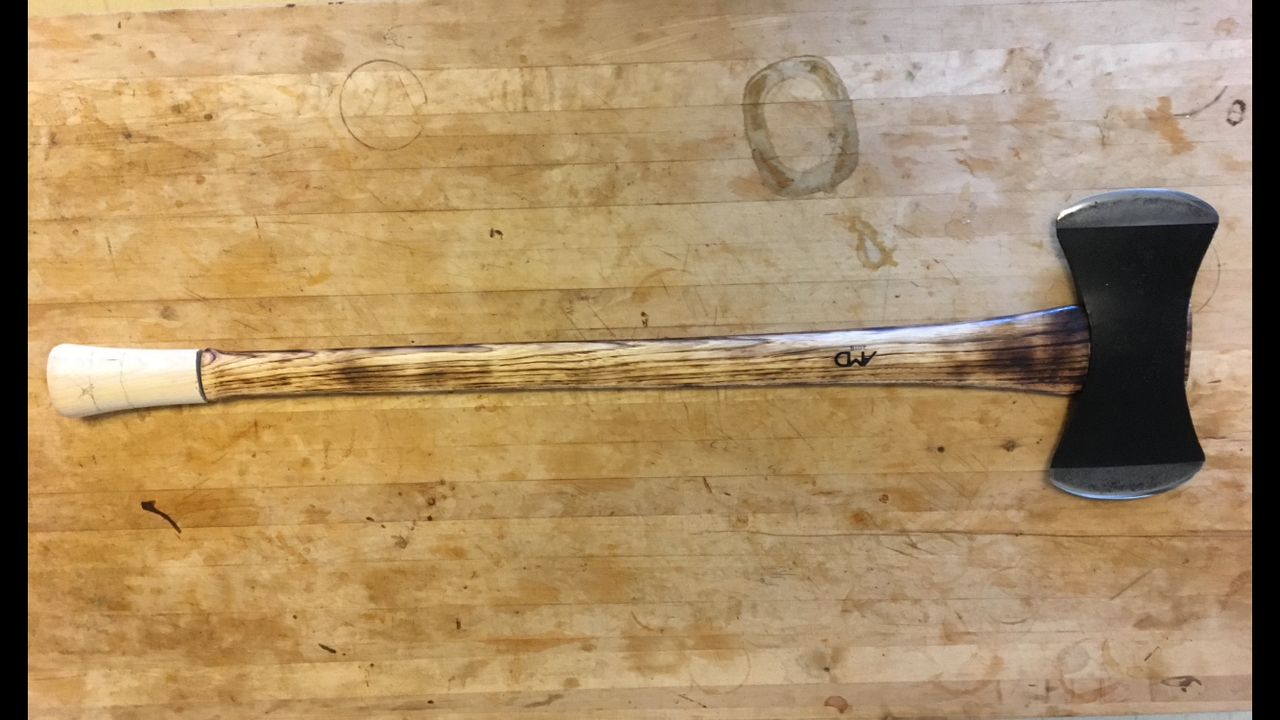

Well I offered to refurb it for him.
Spent two hours on it last night
Grinding the chipped edges back then hand filling the new cutting angles. Wire wheeled then sanded just the cutting edges with 220 grt paper. When he brings me a handle I’ll hang it for him.
I must admit I don’t have a lot of experience on testing axe steel.
It filed the same as every other axe I’ve filled. I’m sure it will work just fine.
