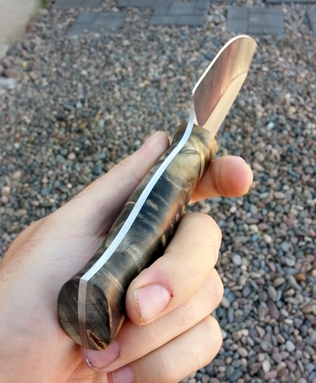

I don't make very many full tang knives, but have been thinking of making a few basic hunters. I see both styles from lots of different makers, and I see +/- of both. Safety being the biggest + on the lower sketch, and flow, in both looks and possibly in use, of the top pic. It might help my blood flow too.
Just thought it would be interesting to see what you all prefer, and maybe a short reason why. This is just a general question not picking a part my quick sketch. The lower pic could be with or without the mini Choil.

I like the first version. It has to be done right though! ...you need room and good indexing
Both choils can work very well when done correctly but I prefer the more snag free action of the first.
You can sharpen it all the way back or leave the grind thicker where the index finger meets the metal.
Here's one way to do it... the area where the index finger normally rests is thick and rounded for comfort. It is a single bevel grind by the way.

Cody,
For safety purposes, I usually put a .125" radius on that back corner. That way when you sharpen it, the edge start is moved slightly forward and around the corner from your finger.
Plus, the squared back as shown above can sometimes catch if cutting in reverse after a follow-through, depending on the geometry. I don't think the knife above would have any problem. Not really a right/wrong thing.
Edit: here's how I've been doing mine (this is one of my earlier knives, my plunge/edge thickness are better now) :
Edit2: I do the second style sometimes too, but without the notch. I'm not really sure why I do one and not the other. Just mood I guess.
