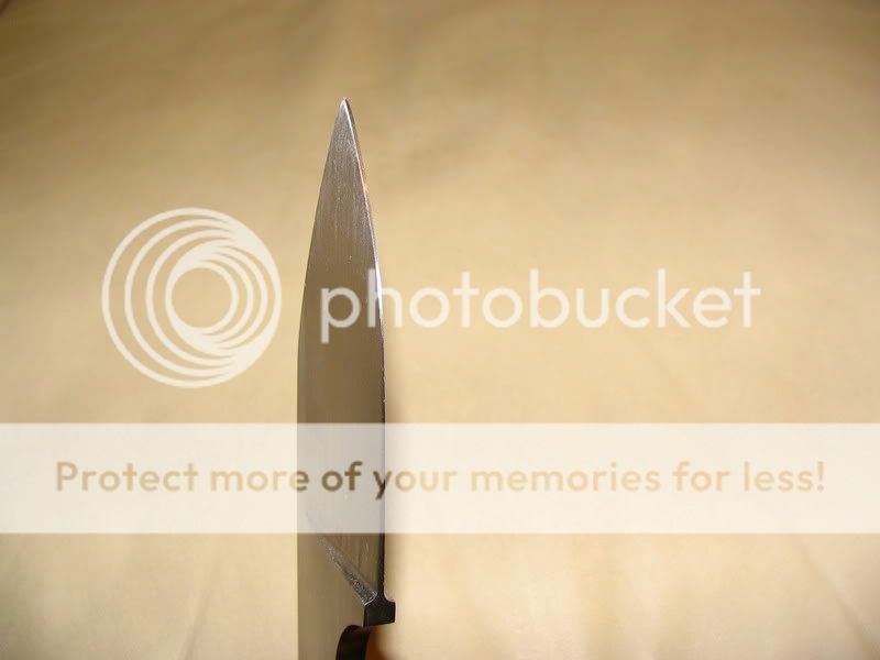

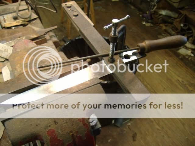

When I made my very first knife using hand tools, I marked the center lines, cobbled together a makeshift file guide, and used a round file to file down to the line (leaving the proper pre- Heat Treat edge thickness.) Then lots of filing and draw filing was needed to get the rest of the bevels to the same thickness.
I don't know if this was the best way, but it seemed to work out fine and get the job done (eventually). :)
Paul... Thank you for the pic of your plunge cut made with a file. I get the idea a lot better now. A picture is worth a thousand words. :D

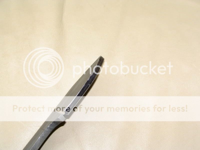

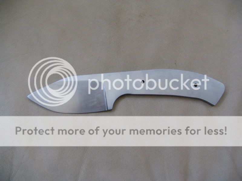

No problem...I like pictures too!
Here is what it looked like after the rest of the filing, and then the finished knife.
Hope that helps!
