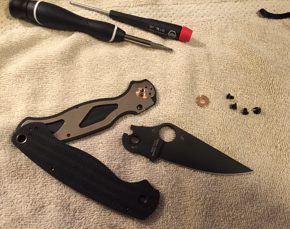

Love my PM2's. I have five altogether. My question is on some the blade drops freely when releasing the lock (which I like for one handed closing) while others do not drop freely. I've tried loosening the pivot screw but it won't budge and must have loctite on it or something. What's the word on this and is there any way to adjust?
To get past the loctite all you need to do is heat it up with a hair dryer and it will eventually break free.
Sent from my SAMSUNG-SM-G530A using Tapatalk
I am not recommending taking it apart but, that is how I have fixed every PM2 that I have had that wouldn't drop freely when unlocked. In every instance I found that there was a spillage of the Loc-Tite that was on the blade and one of the washers. I've done this to 3 PM2's. I took the entire pivot out of the knife and cleaned the blade, washers, everything. Then I put it back together. I didn't remove the lanyard tube, I just pushed the scales apart as you can see in the following pic. After putting it back together, all was perfect. Blade dropped freely when unlocked.
Acetone, which is in nail polish remover, effectively removes Loctite.
