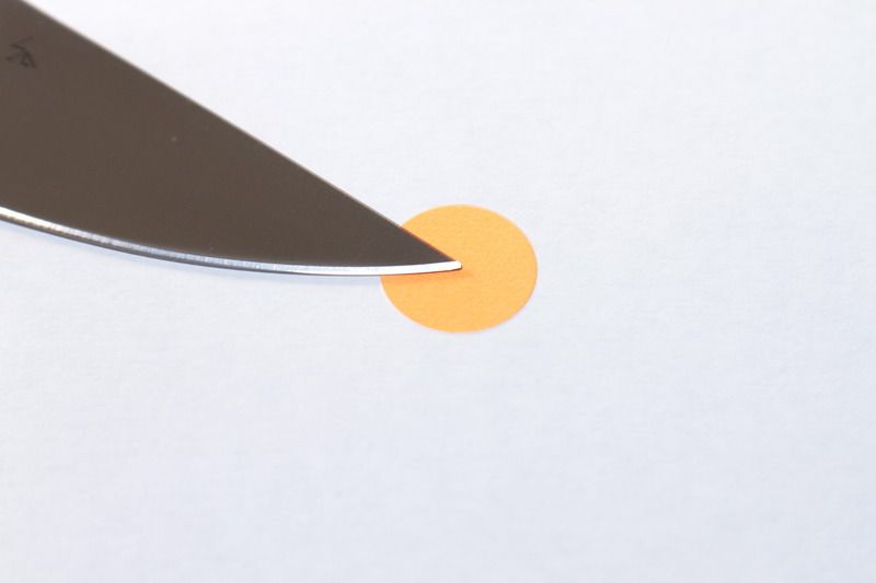

I used to say "always repair spine side". But after making a few repairs... every knife is different, and also you can repair in different ways for different results. I've showed this before... I used to buy broken knives to practice on. Here's a couple of Leeks repaired (top: no repair / middle: from the edge / bottom: from the spine)
Depending on the knife and the desired result, as you can see, it can be done a number of ways. In the above example, an edge repair more closely matches the original knife, while the spine 'fix' gave it a whole new look. In the case of the OP, it's such a small repair, it shouldn't matter either way. He could do it from the edge, making the tip a little stronger, from the spine to keep it thin, etc. If it were a bigger break, and he wanted to try and re-establish the "needle point" desired, it might help to do a little on both sides.
Bottom line, no real rules (well one is, don't grind so that the tip sticks out on a folding knife when closed)... with bigger damage, draw on the knife, see what it would look like, and then grind it however you want. Like I said before, a good sharpening should erase most of this without much hassle... finish it spine side if needed.

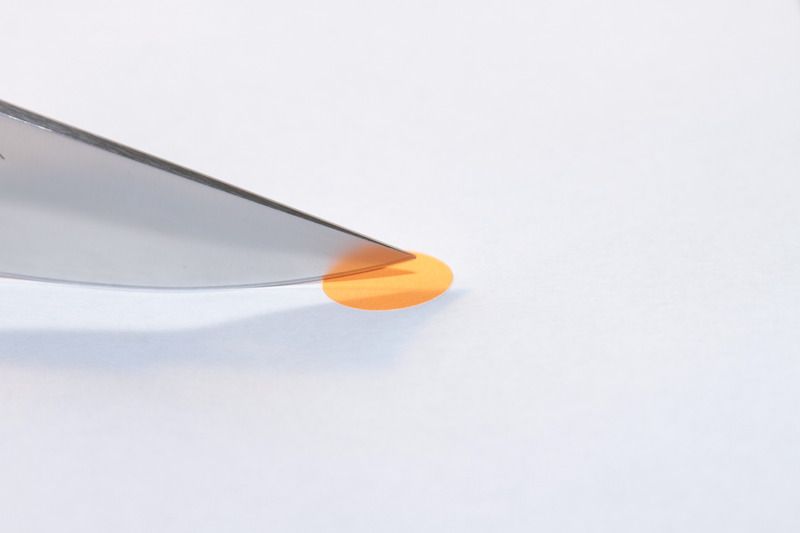

Just finished repairing a broken tip on a ZDP-189 Leek I'd been sitting on for a while. Quite some time back, I'd rebevelled it to a very acute edge; probably a little too acute, as it turns out. Immediately upon finishing that work on a DMT hone, I managed to snap about 1/16" of the tip off while STROPPING it; the tip dug in on the strop, and it broke as easily as the tip on a freshly sharpened pencil.
Fast-forward to today. I had an idea to to use a makeshift 'hone' I'd constructed previously with a 3" x 21" sanding belt (120 grit 'Zirconia Alumina'). I'd picked up the belt at Sears a while back, cut it at the seam and glued it flat to a 3" X 24" board of basswood. I had previously used this rig to reshape the spey blade on a Buck 301 folder (420HC) into a spearpoint tip, by simply laying the board across my lap and grinding the forward end of the spine with trailing strokes along it's length (21"). That job took maybe 45 minutes to an hour or so. Today, I decided to employ the same method on the ZDP-189 Leek.
A total of 20 minutes' work (yes, I actually timed it) took the broken tip from this:
to this:
It went even faster than I assumed it would, and I think the new tip is actually pointier than the previous one. Now I can start worrying about breaking it again. :D
