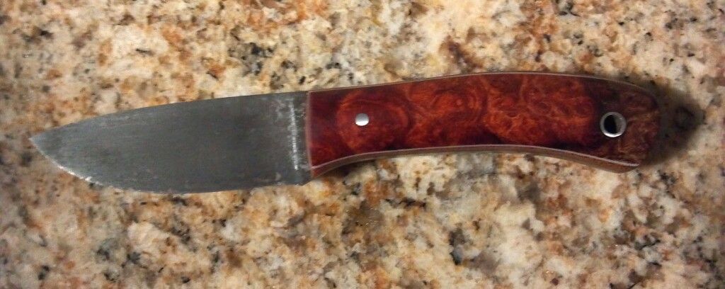

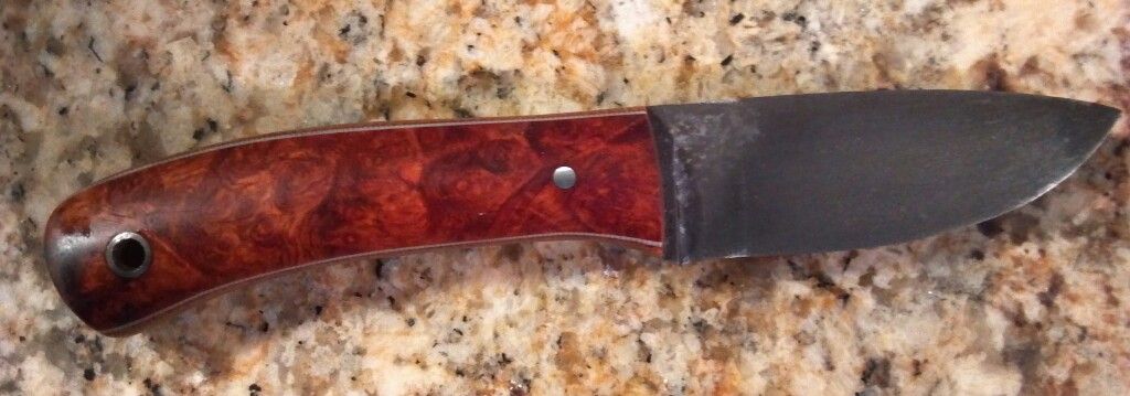

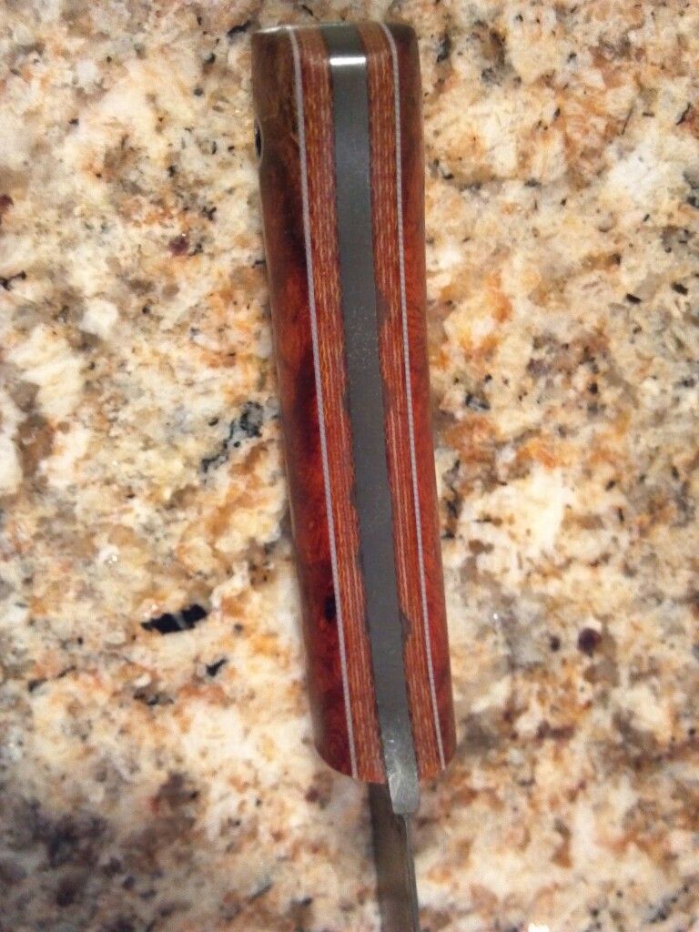

So I came up with that pocket edc and was sanding the handle yesterday and noticed some weird stuff going on with the liners. I didnt think about it until I got up to 400 grit and realized what it was. I drill small holes in the liners so the epoxy will have somewhere to go and didnt trace the tang onto the handles this time. Well, I drilled like I normally do not thinking about how narrow the tang was on this knife! Now I have small half rounds showing up filled with epoxy. I like the knife but obviously cant sell it so its going to the sheath maker for a pattern. See the holes on the liners?

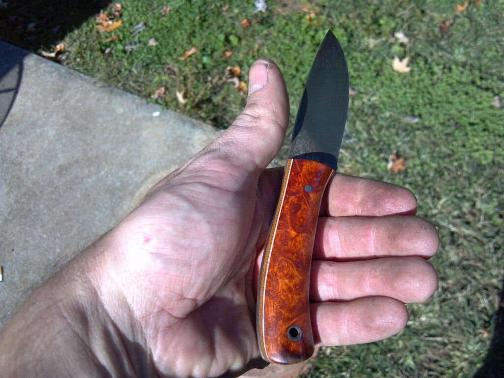

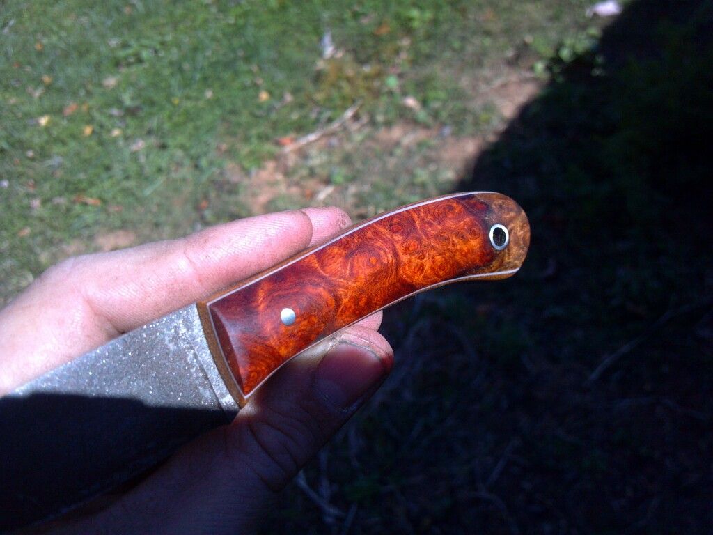

Ok guys, If anyone wants it for 45.00 shipped without sheath its yours. Ill have to make another one anyway for a pattern. Here are some in hand shoys and a better pic of the scales.
3" blade, 3 1/2" handle
Amboyna burl scales with brown liners and white pinstripe.
