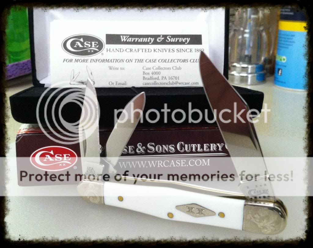

From my perspective, bone is extremely durable, while wood products are the least durable. Of all the synthetics, I will say Dupont's Delrin is the most durable, while the new wave micarta's and G10's running second in durability. As far as attractiveness of Delrin on a knife, you be the judge....

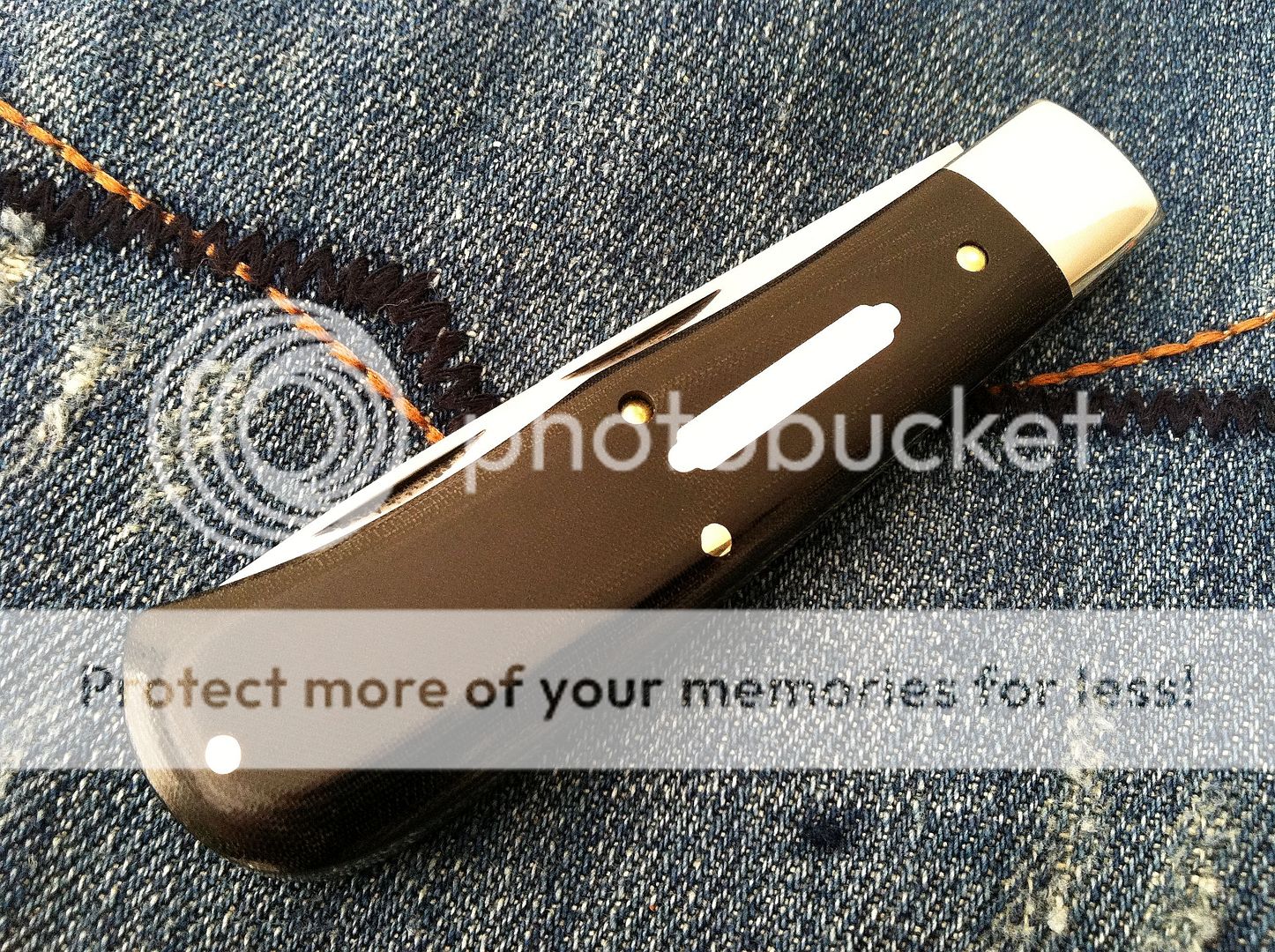

G10 may not be the most traditional material but sure is tough.

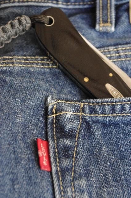

G-10 looks OK to me on Traditional knives.

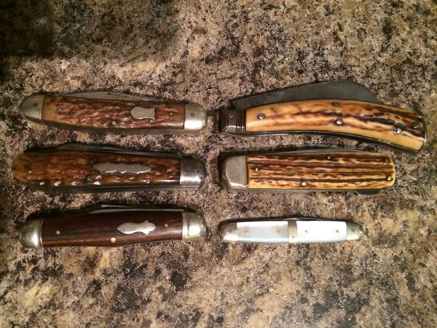

Here are a couple of old working examples in bone,wood, stag and pearl. All in great shape and all have seen a decent amount of pocket time even before me! Just to show that while micartas and g10 are extremely durable, if it is a traditional handle material them it has stood the test of time and should work well. I am somebody who kind of shakes my head a bit over "most durable, longest lasting....." It's a knife, it's meant to show use, and unless you are abusive with knives then any materials in modern use should be good enough to last many years. And to be honest I usually run into cracked handles in synthetics when looking at older knives in antique malls, flea markets etc. The bone and wood handles seem to last better in my experience from these examples.
