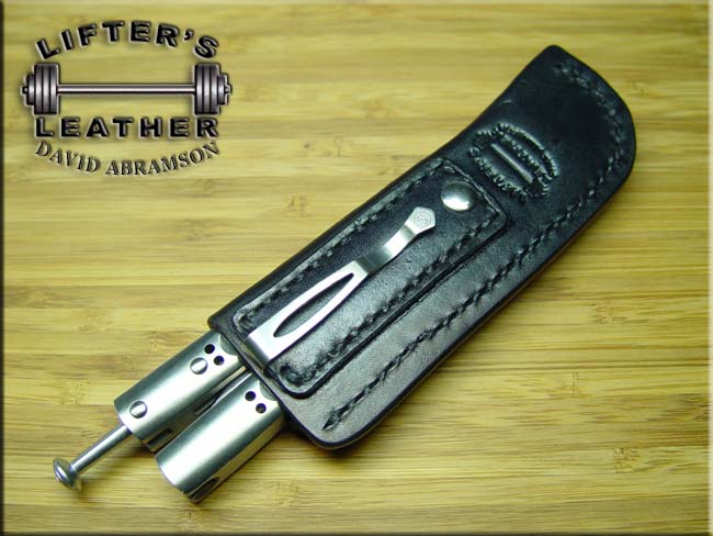

I gotta admit, one of the things that has always most drawn me towards the tactical folders was the pocket clip. I never could stand the old SAKs, Stockmen, etc. that inevitably slide down horizontally in my pocket. Hence the reason I was starting to carry small fixed blades most of the time before I turned 12.
What I was wondering was if there's any way to obtain a sheath for folders that would keep them vertical, ie; a William Henryish set up? Is there anyone that makes one similar, or even a way to make my own, etc.? If I can ever find one, I'm pretty sure my SAK Adventurer will make it back into my EDC rotation rather than living in my truck.

Or try the cheap fix . . . make one out of wool felt (or a decent synthetic with some texture). Take a piece of felt 1 to 2 inches wide (depending on breadth of knife) by 10 inches long (again, depending of length of knife). Fold the fabric, but not in half . . . this is the key. Using 10 inches as the example, fold the fabric to create a four inch pouch, and whip stitch the edges. This leaves an extra two inches of fabric at the top. Why? Drop it in your pocket and you'll see. That knife will never fall horizontal. The friction of the wool against the inside of your pocket, particularly with the extra tab of fabric at the top, holds the knife vertical. Is it a quick draw? No. But it keeps the knife vertical and protected. I pull mine out by the tap of fabric, flip, and the knive drops out. Cheap and easy - two of my favorite adjectives.

FWIW, if I hadn't found that I probably woulda done the thing with sewing a pocket sheath with the wool lining. Lifters stuff looks fantastic, but perhaps a bit extravagant for a $20.00 knife.
