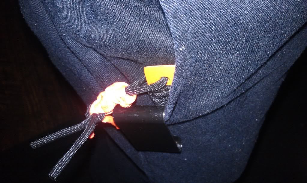

My brother likes to carry his small fixed blades in clipless KSF pocket sheath that has an extra slot for a penlight. It carries and draws great. I think the extra width that the additional slot adds makes it sit nicely in the pocket. Without it, it might flop around a bit. (Pure conjecture)

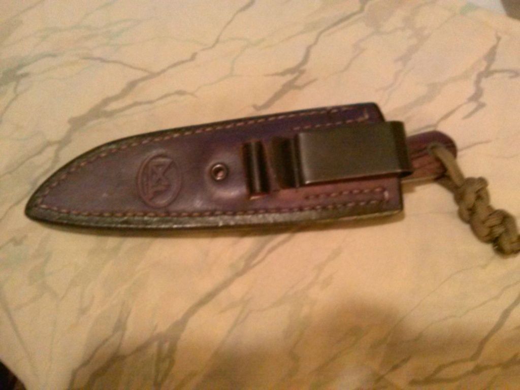

Here's an example of leather and kydex with clips that sit right at the sweet spot. The kydex was a jerry rigged with the clip from an old pistol holster. Went well with the slim Scrapivore.
(Please excuse the poor photo of the DLC Pocket Fixed blade that I just snapped. It does not do Drew and his father's work justice.)

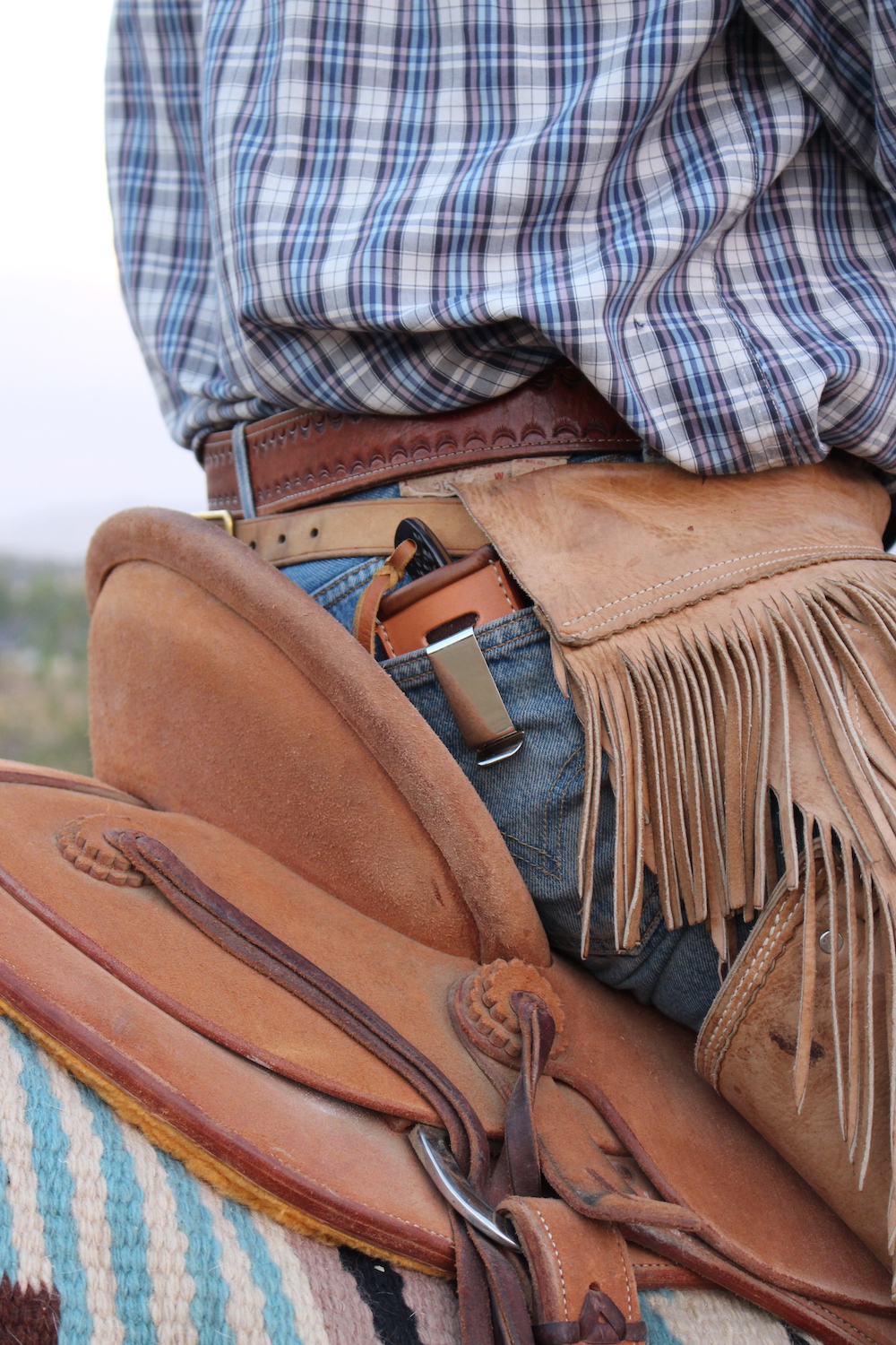

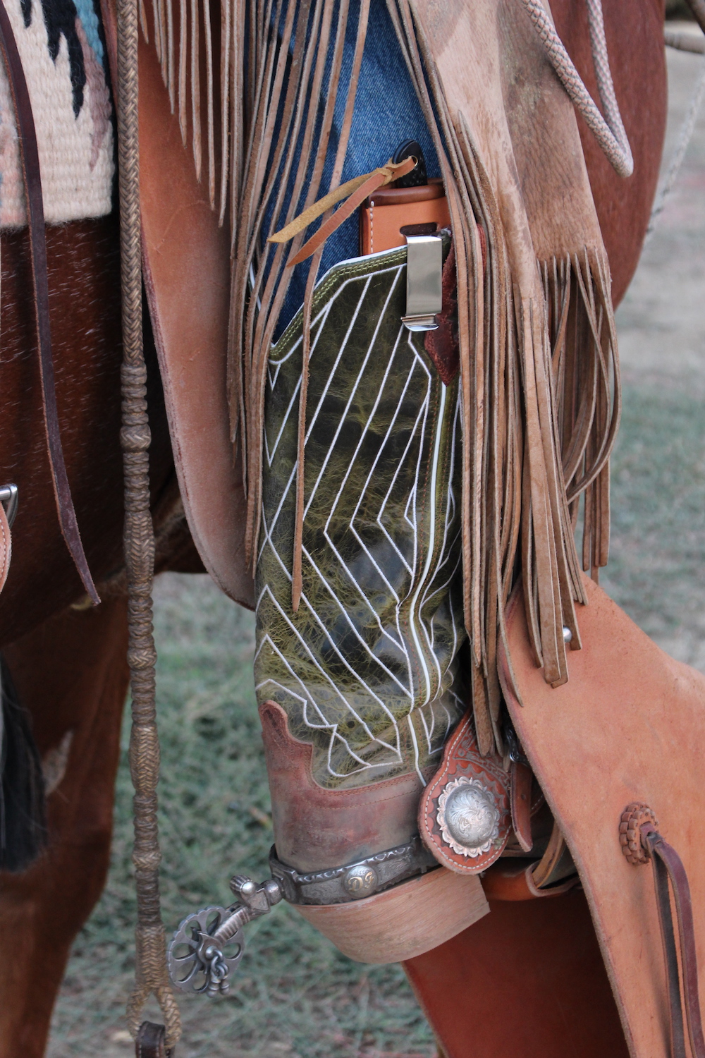

Absolutely the clip. As Ken says allows different options.
Inside the waist band is probably my favorite way of using this type of sheath.
Yes, also Paul (Sheathmaker) has some fancy ones he sells. I get those from Weaver but Tandy has similar if not the same.
These are the clips I use and keep on hand for my friends in the leather craft community. They are ideal for pocket clip carry and I have used them on some boot sheaths as well. High quality, heat treated stainless steel. I prefer them to the larger spring steel versions.

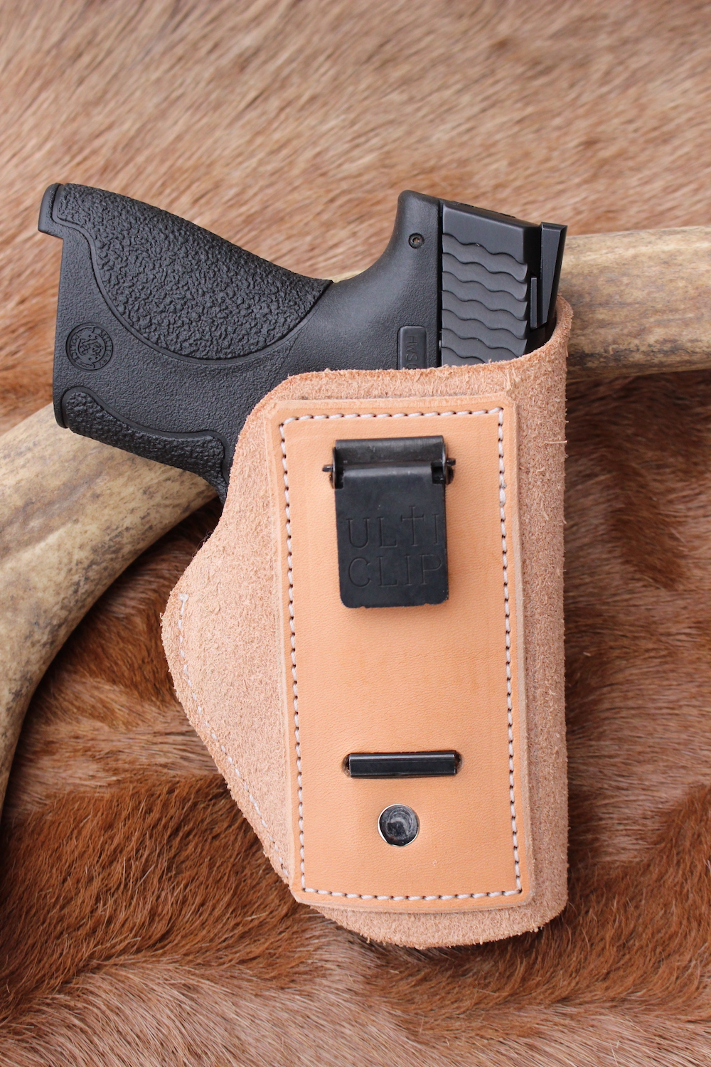

Ken I have two different ways that I use depending on the project. Both are rather pedestrian compared to Paul's method which is a really cool way of doing it. Both use a rivet. If the project is lined I rivet the clip into place and if not I make a sleeve which is sewn into place but the clip is riveted to the sleeve. This does leave a little bump from the rivet as Paul mentioned. However I take pains to mimmimize it by making sure that rivet has had a smack down administered. There is a relatively new clip out called the Ulticlip and we've used it on some holsters. It has a roll in the steel at the bottom that allows it to come through a slot in the sleeve. The idea is that you can move the clip from project to project. I havn't experimented with that yet and have riveted these clips on the few I've used but it is worth a thought. The Ulticlip is expensive, ($10 to $12 each) but is the strongest holding clip out there that I've seen. It has a camming action that closes the clip tight. Works exceptionally well if you are clipping just to the top of the jeans and not to a belt.
Here is a pic of one of those clips. At the bottom of the sleeve above the rivet you can see the roll that I was talking about. The idea is that roll will hold the clip in place, rivet not needed.
I found out about these clips here on Sheaths and Such. For this application where ya sure wouldn't want the holster to come out with the gun, if ever needed, they are superb. Due to the camming action of the clip they really hold on there. One video I watched estimated their holding power at about 70 lbs.
