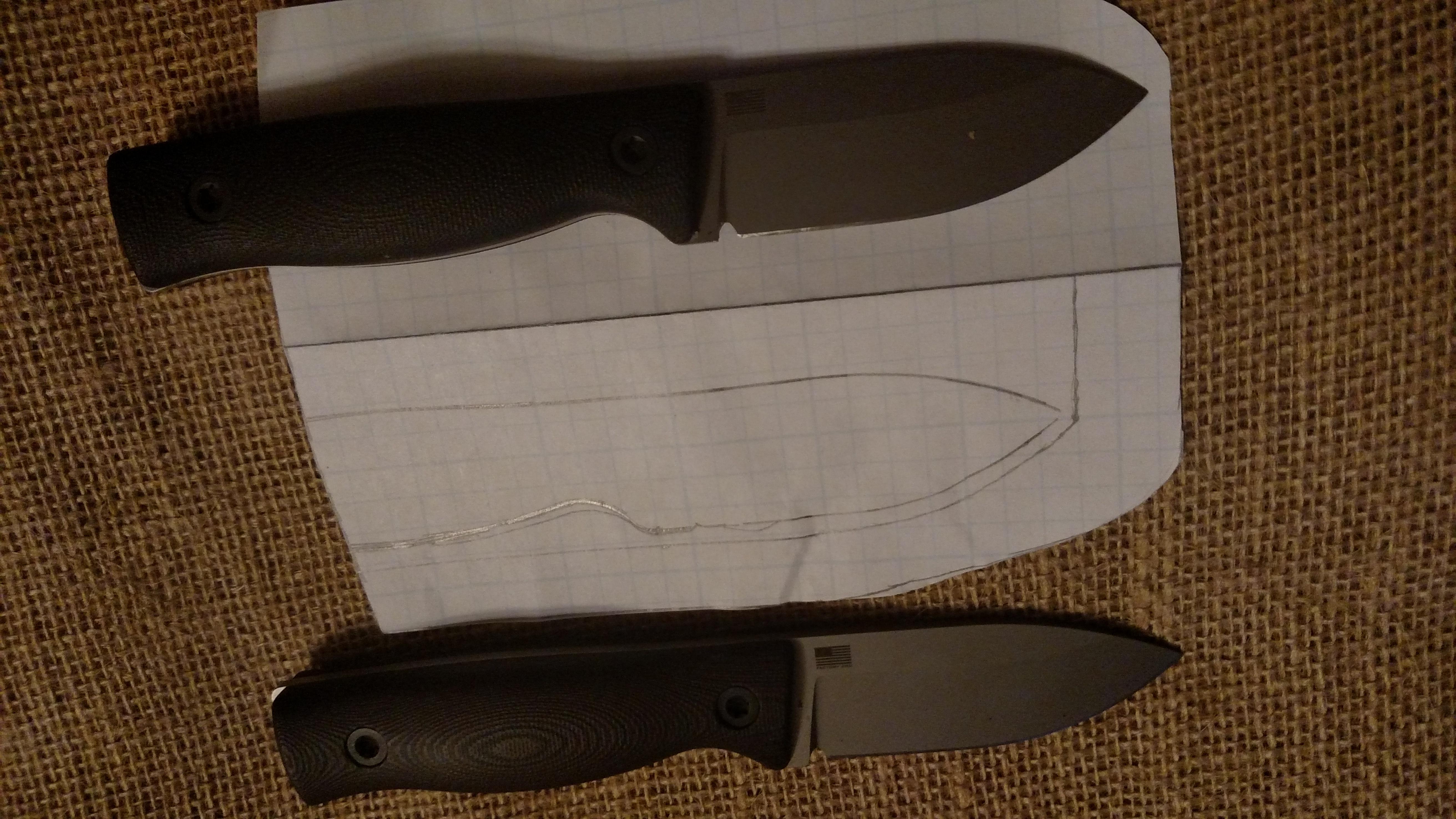

The knife is a Survive! 2.7, it's a little thing, seems a good fit for pocket carry. Pretty simple pattern obviously, no belt loop to worry about.

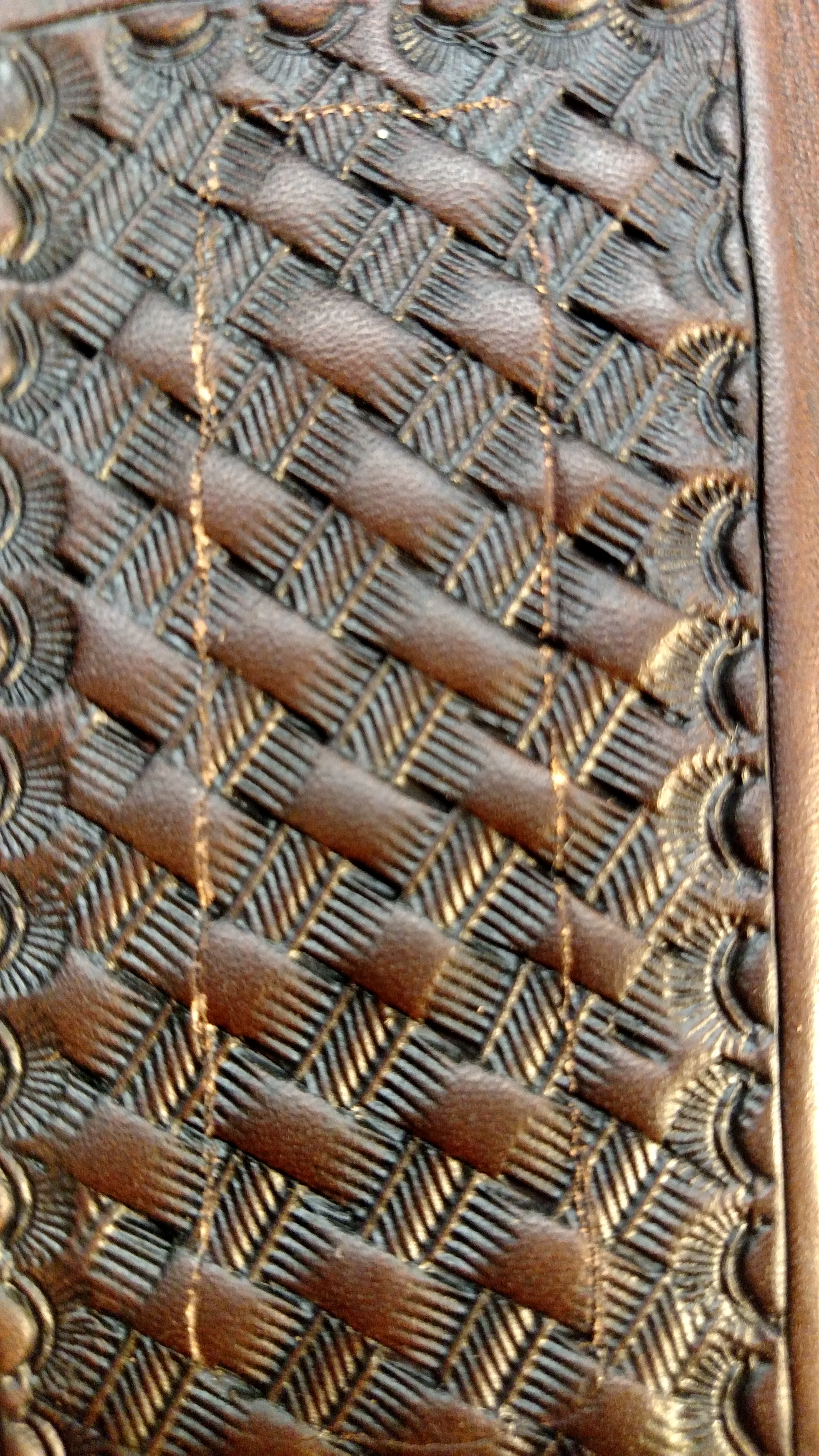

There's going to be quite a bit of stitching on the inside of this sheath so I made pretty deep groove marks where the stitching will go in.

After the barge set for about 15 minutes I cemented the two together and clamped it together for about an hour then sewed it up.

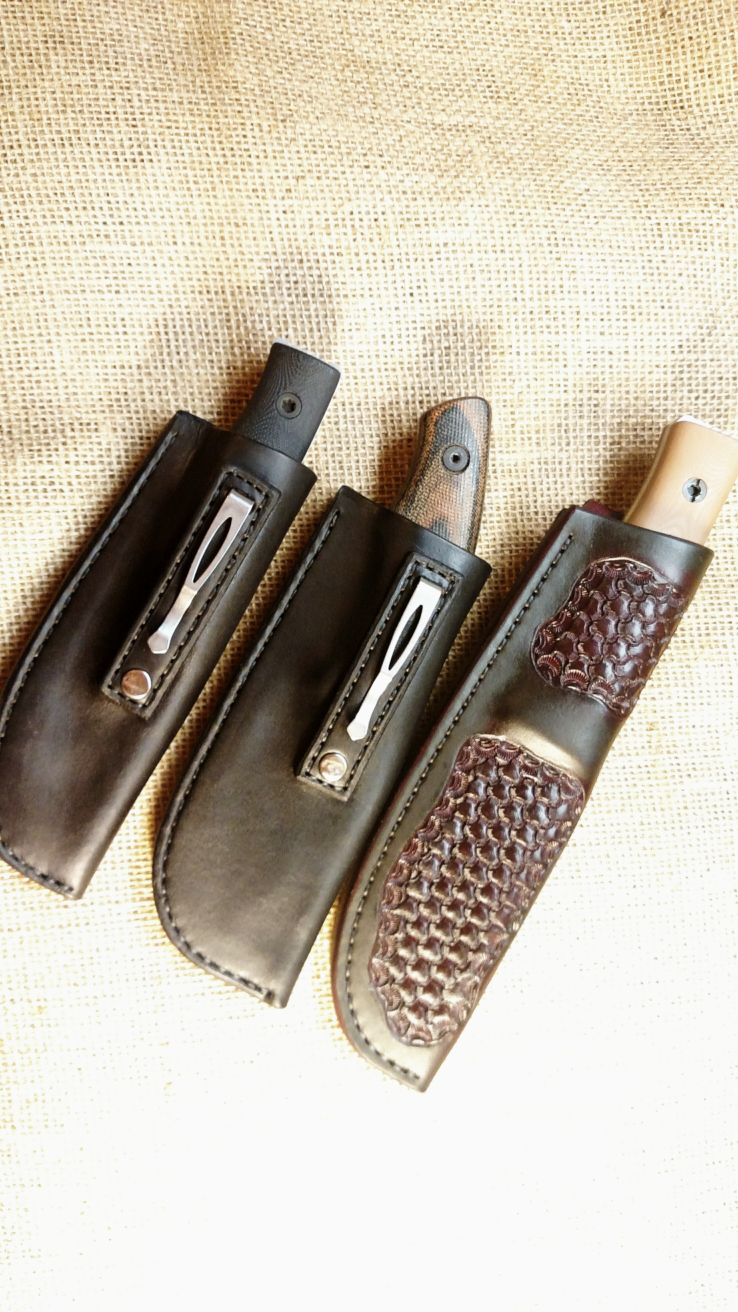

Here it is after a couple coats of Tan-Kote were sprayed on (my first time using Tan-Kote in a spray bottle, I cut it to about 50% with water, seemed to go on pretty smooth) and a coat of Montana Pitch Blend was buffed in.
With a couple companion knives and sheathes, a Carothers Performance Knives Field Knife and another Survive!, their 5.1.
So there you have it. What may or may not be the right way to put together a pocket sheath with a clip. The clip I used came from a knifemaking supply site but looks about the same size as the ones Tandy sells, I'll probably try mashing it tighter and if that doesn't do the trick I'll look around and see what I can find elsewhere.
