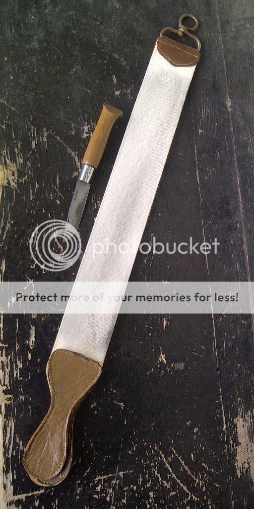

Think of an old time barber stropping a razor on that big flat piece of leather.
I have used tons of strops and they all have a great purpose but I have been sticking with an old barbers strop for a few years now. There is a reason barbers could shave your face after they made a few swipes :)
Mine is two piece, horse hide and linen. They are more difficult to learn but once you get the feel and more "the sound" oh my they are a force to be reckoned with :)

I'd suggest a bench or handle strop. Nothing wrong with the hanging variety, but for whittling you'd want something more portable.
Image by Schwert
