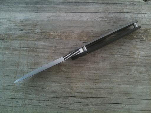

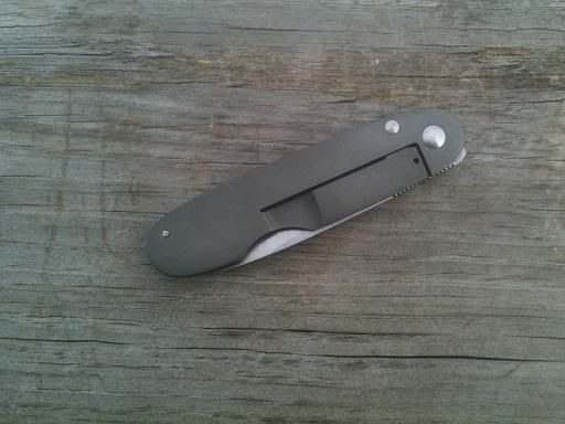

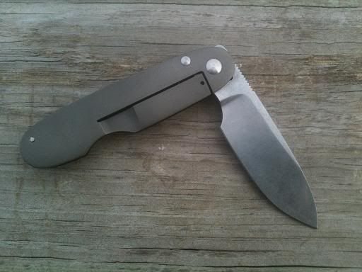

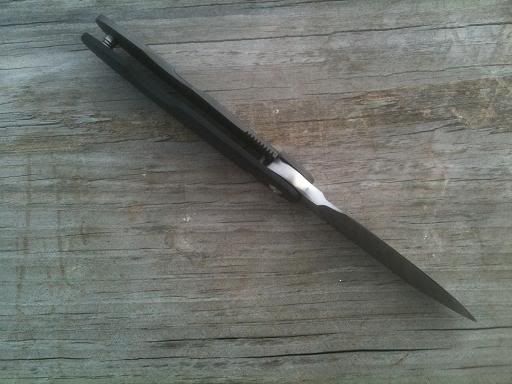

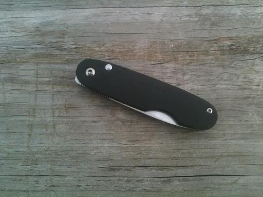

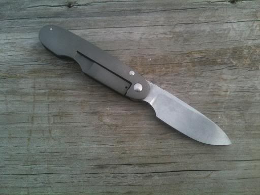

Hey guys,

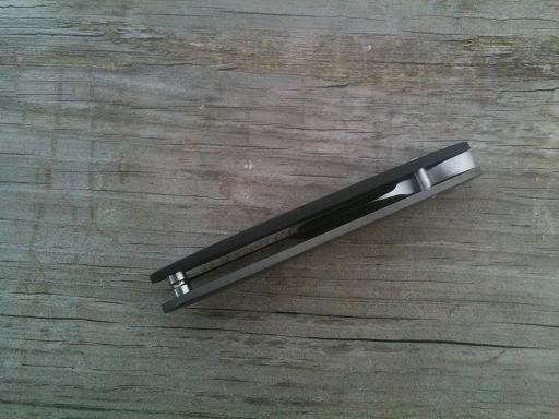

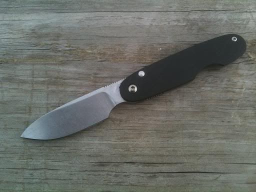

Heres a, sort of, design in process build. Made this one with an "office carry" type of mindframe. I work in a govt. office, so discreet and sheeple friendly is a good thing. I really love the EZ open pattern slipjoints, but wanted to incorporate that into something that locks.
This one is a prototype, the design has a few bugs to work out, its very smooth and lock up is solid, there are just a few things I want to do differently on the next one.
The large finger choil was an after the build type of thing and I wasnt sure about it, I'm still not, but it actually works really well for holding the knife allowing you to get a full grip on the handle and I like the way it matches the EZ open cutout.
Just something to carry in the pocket for boxes, mail, etc...Nothing fancy here, just a plain ole pocket knife I think it has some potential. Next one will have full ti scales, non locking and locking with likely a stainless blade most likely.
What'cha think? Love it? Hate it?
Specs:
Blade is 3/16" tumbled 1095
.125" contoured Ti lock scale
Black G10 non-lock scale
Ti backspacer
S/S Hardware throughout
BL: 2 3/4" with a 2 1/4" cutting edge
HL: 3 1/4"
OAL: 6"
Thanks for checking it out!
