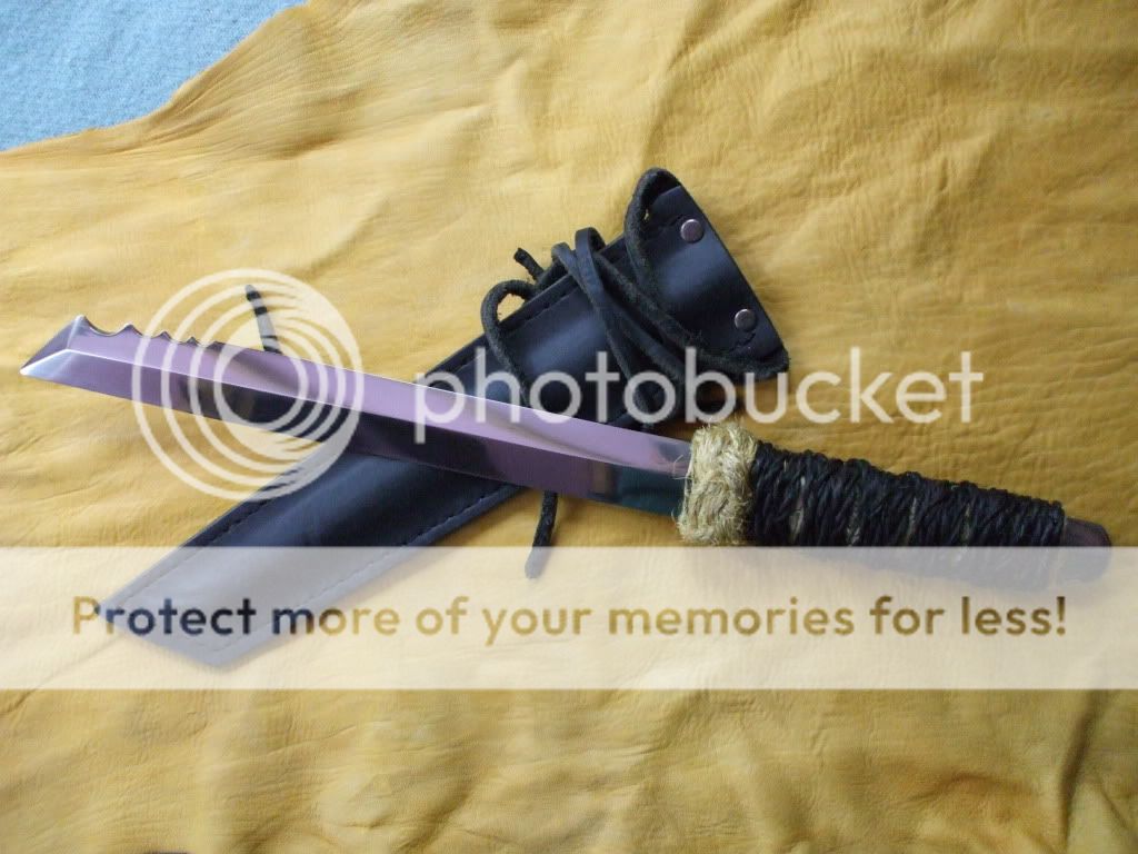

I'd also love to see a picture of your blade, as well as any you've done in the past like this.
- Chris
Here is a knife made in this style, from back when I made a lot of stuff from chipper and planer blades, this one turned out to be edge hardened (only chipper blade I have found like this) so the satsume-age style presented itself. Bevels run all the way to the tang extension. Turns out this is a very practical profile.
