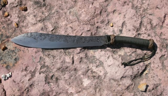

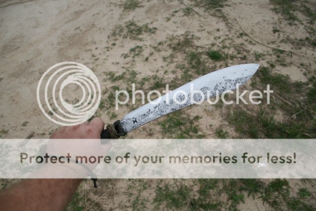

This parang was a commission from a customer who wanted something similar to the previous parang I posted, but gave me a free hand if I wanted to try something new. This is the result, one with more of a point to it.
The steel is 5160, triple normalized, triple hardened, and triple tempered. The integral socket handle is wrapped in olive drab paracord with coyote brown two-strand Turk's head knots, impregnated with Minwax Wood Hardener. The blade length is 14 1/2" and the overall length is 20 7/8". It shaves hair of course.

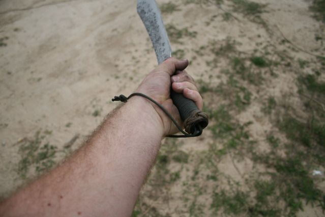

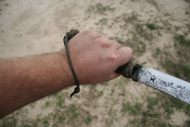

The customer wanted a lanyard, somthing I've never added to a bush sword before. With the integral socket handle, it was fairly simple to do, though. I tied a length of paracord in the center around the choil, ran the ends through the hollow of the handle and out the back, then tied it off.
