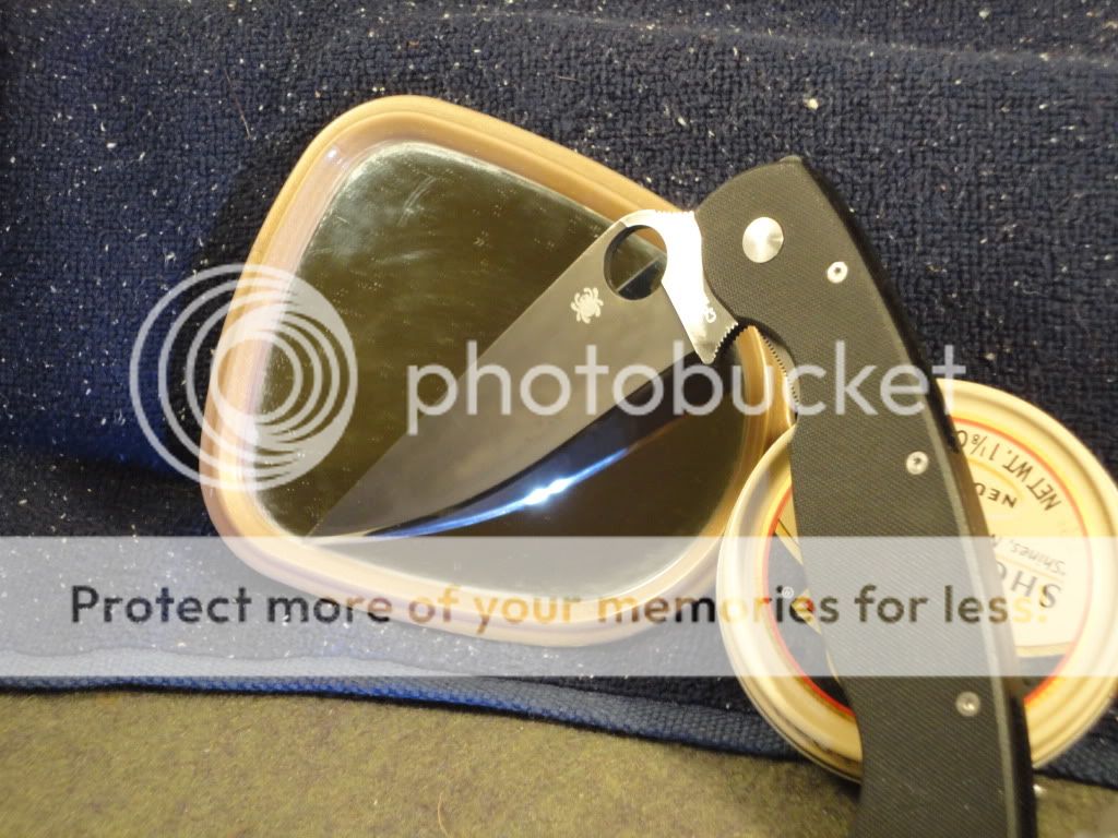

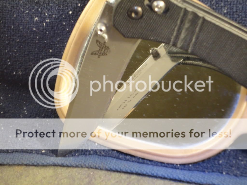

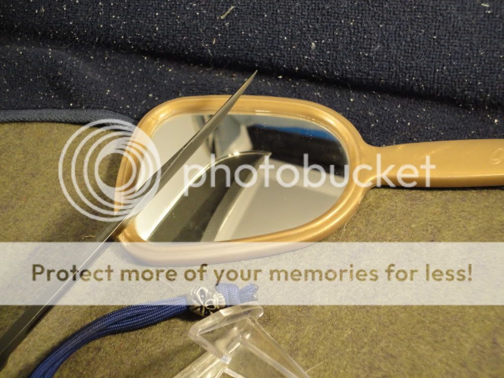

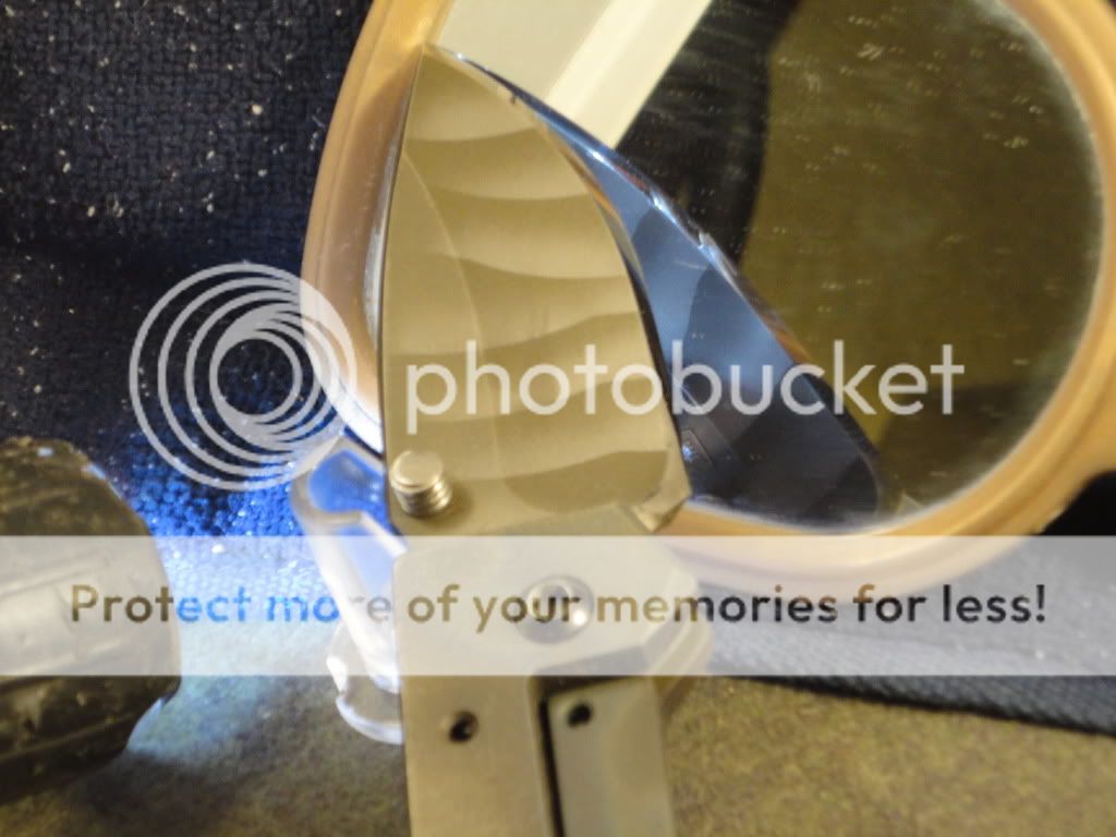

millie by ankerson--b.m.m390 by ankerson--crusader forge, knifenut1013--endura zdp, mine--& kabar mine.
the light area on the millie tang is where coating was removed so phil wilson could check the s30 rockwell. i'm sorry i ca'nt get these pics clearer since the edges are really pretty.the crusader is triple tempered s30 & really a hot performer.black blades & mirror bevels are great.
dennis
i think i should mention that individuals desiring to use these type services by most knife sharpeners should realize that it can take a full hour & sometimes longer to get this done to their knives. i can attest that it gets very tiring standing in one place & going thru all the movements, changing stones & cleaning stones & tapes as you proceed. i do'nt do it except for good friends & i would expect a charge of 45$ plus to & back postage to not be unreasonable.

singularity is correct. although these edges may look fragile , remember ankersons grueling sisal cutting tests were done with these type bevels. i do'nt get mine as sharp as knifenut 1013 or ankerson but go on down to the 6000 tape to get a good polish. then i make a micro bevel on the white spydie ceramic hone. i do this so i have the advantage of friction reducing bevels but if i hit a bone or rock i'm less likely to ding my edge.however a careful well coordinated person can use the 6000 tape on glass & use it as edc.

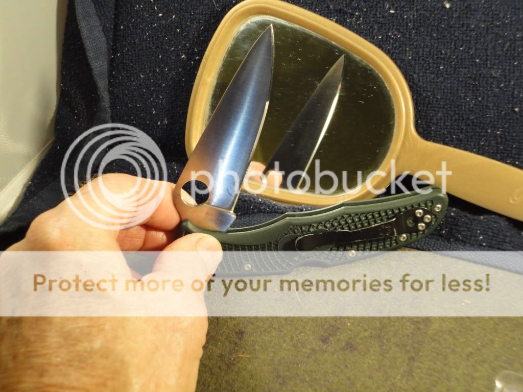

Dennis, with the precision that you and Jim can muster up a polished edge, I am starting to believe that you guys can walk on water! ;)
my polish is not nearly as good as knifenut & jim's --you have to keep going at it. hopefully the next one will improve.thanks for looking.
dennis
You need to get into diamond/chrome oxide sprays/powders and high grit stones Dennis ;)
Mucho deeper polish, but alas, just the grit isn't enough, steady hand and consistent pattern play important role.
