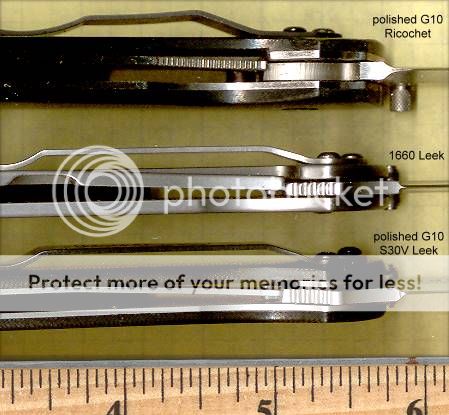

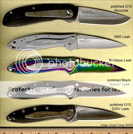

Family of Kershaw/Ken Onion Leeks - with the Ricochet (polished G10 CPM440V - model # 1520)
Closed clip side -
Locks -

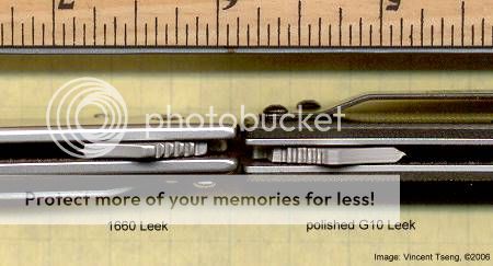

The Ricochet has full titanium liners - whereas the polished G10 Leek has steel liners.
Thickness - G10 vs. all steel
The S30V on the polished G10 version is satin finished - but pretty "coarse" - the rub lines can easily be seen - very similar to the satin finish of the Ricochet. I think I prefer the stone-washed finished blade (on the textured/matte version), but much prefer the polished G10.
There is one small point to note - and one can just see it in the thickness comparison photo - being a more limited edition and the satin finish - the blade has squared off corners - without the smoother rounding of the other versions - it is felt most noticably on the filework/ribbing on the flipper/index-open - it feels much sharper and not as comfortable as the more smoothed out rounded ones on the other versions......
Overall the polished G10 Leek looks almost like a hand finished knife.

The S30V blade of the polished G-10 Leek
next to the 440A blade of the 1660 all steel Leek,
and the CPM440V blade of the Ricochet (also polished G-10) which also has a very similar coarse satin finish.
Notice this polished G10 Leek satin S30V blade has an edge bevel that looks about the same as the 440A all steel Leek. And indeed it is - its cutting performance through corrugated cardboard was about the same as the all steel 440A Leek (whereas one may recall the G-10 S30V Leek (matte version) with the stone-washed finish blade had a more obtuse edge bevel and did not cut through the cardboard as well).
I have touched up the S30V blade with some light strokes on fine ceramic V-hone crock-sticks, and was VERY surprised to see what looked like fold-over edge!
It took me quite a lot more work to get rid of that burr/fold-over than I was expecting. I have only seen this on 420J2 and the stainless steel Opinel (only near the tip). Also the edge under 30x magnification seems coarse/jagged (like there is micro-chipping) even after some stropping/polishing on cardboard - whereas the 440A blades take a nice smooth polish no problems - as do my SAK blades.
