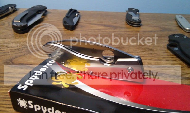

Hey guys just got this Lum Chinese Titamium the other week and I love it! I decided to polish up the titanium scales...the flat silver was a little too boring for me! Here's how it turned out, sorry for the crappy pictures I will try to get some better ones eventually. Its not perfect but I think it turned out pretty sweet considering I only have about 2 hours invested.

Yep figured that out when I was reassambling it! :( This won't be a hard use folder so I'm not too worried.

Very simple actually:
Started out with some 600grit wet sanding and worked up to 1500 then finished it off with some blue magic metal polish
Im very satisfied with the results.
Thanks very much! Did u use a blockand hand sand it or did you use a palm sander?

All by hand!
