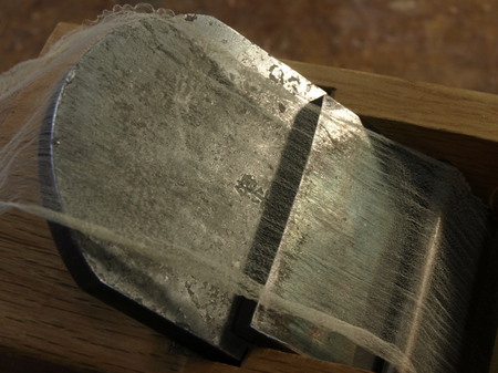

I found a blog of a Japanese wood worker testing this.
EFBC90EFBC90EFBC99E38081E58685E4B8B8E9898BE78AB6E382A4E383A1E383BCE382B8E59BB3-248ac.JPG
His conclusion was that it works well for a plane (but it was more like JIS #1,000/10,000 hybrid).
The guy claims that he was able to whittle out a 2.5 micron slice.
m_EFBC90EFBC91EFBC98E38081EFBC92EFBC8EEFBC95E3839FE382AFE383ADE383B3E381AEE9898BE3818FE3819A-f98e4.jpg
I guess you can read it with Google Translate.
seisakunohibi.blog.ss-blog.jp/2010-12-10
I tried it myself but gave it up because deburring was difficult.
