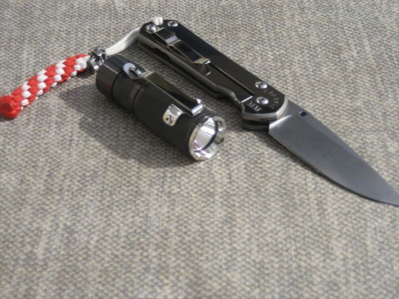

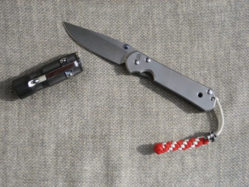

been working on this for a few days. started as a plain classic, i got tired of the brushed scales. the lock bar side didnt turn out as good, and i was going to work on it a bit more, but i stripped the clip screw putting it back on. so, at least for now, im stuck with mismatched sides.
what do you guys think? started with 400 grit, then 600, 1000, and 1500. finished with flitz.
havent decided if i want to polish the blade yet.
I did the same thing myself 7-8yrs ago on a large regular, I got mine almost to a mirror finish. After some time I tired of it and sent it back to CRK to have it refurbished and received a call from CRK and spoke to Chris himself, he said that he had seen others do the same but mine did stand out as one of the best as far as polished ones go:)
But....he said the problem is that because of the tolerances being what they are he said that by doing so I had changed the dimensions ever so slightly that he couldn't guarantee a proper fit etc, so he changed them out to a new set of handles and at no cost but the refurbished fee:D
Keith
Looks pretty good!
I was lazy and just took a scotch brite pad to mine to give it a "working satin" finish. It's held up super well, and rarely needs a touch up (2 minutes max).

dont know yet really. it is noticeably smoother, but its never really had hard use, so i dont imagine it will matter much.
