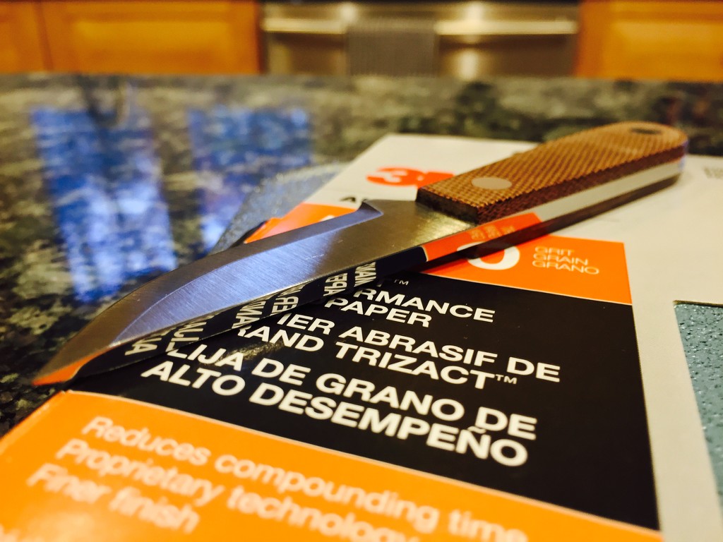

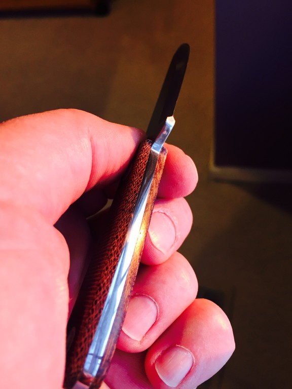

Polished up the spine on my Knecker
Apr 1, 2014
868
Started during the JK shop gathering - just finished today:

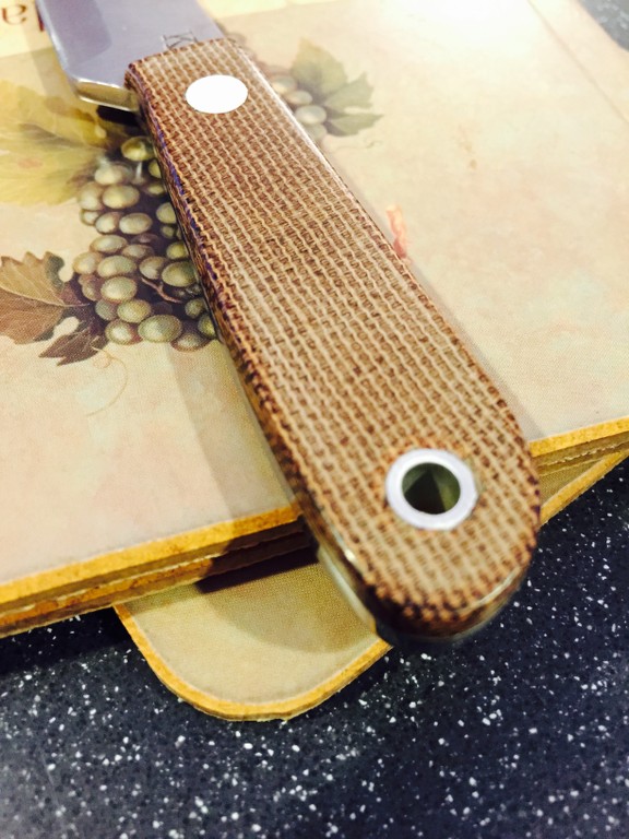

And I put a very slight curved edge on the micarta scales and gave them a light polish:
Loving this knife!

What was your progression in terms of the grits used?

I started with 100 grit and moved up very slowly - 120, 150, 220, 320, 400, 600, 800, 1000, 1500, 2000, 2500, 3000, 5000. I went real slow and kept the edges as square as possible.

Was wondering.....how long do you think it might take a man to polish the entire blade like that?
depends on the set up, I've never timed from one stat to another but as a rule spend longer on the lower grits, it takes me several "man hours" to go from rough up to from 80 to 100, to 150 to 220 to 320 to 400 to 600 at least IME with hand sanding just on the spine,
